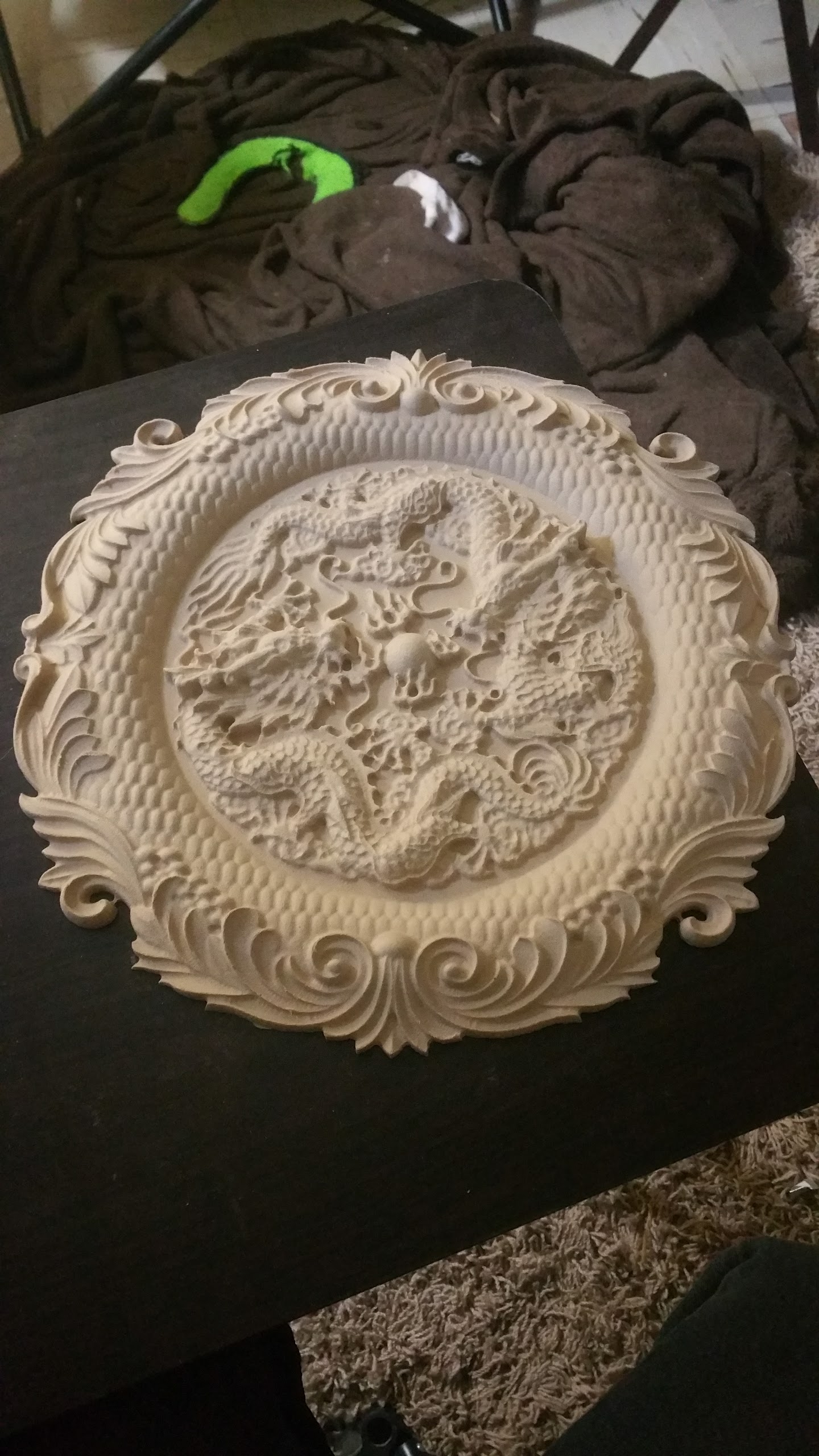

This is the next Asian inspired Yin/Yang piece. Two dragons. If any of you guys wish to cut these for yourself, IM me with your contact info and I will send you the Vectric Aspire project files.
That’s a really nice engraving Rob.
Thi is also MDF?
Very nice, BTW!
Continue to be amazed Rob! I can’t see your scan lines, the pockets are crazy accurate and finely detailed.
How many hours did this run? How many tool changes?
@Alex_Paverman Yes it is mdf. Ill be sticking to that till Ive mastered it. then I will delve into other materials.
@Brandon_Satterfield Thanks for the complements. ! tool change. 1/8" ball mill and 1/4" ball mills. I was running the machine at around 200 in/min and had some issues then slowed things down to 150 in/min and no more issues. final cut took about 5hrs. roughing about 3hrs.
I got around the x or y raster lines by using an expanding round cut pattern rather than raster cut on finish pass. However I did use raster for the roughing passes. These options are available in Vectric Aspire v.9, which is what I use.
Absolutely stunning! Scroll saw to cut it out? or CNC?

I really wanted to try a model of your kind but all my MDF carvings made have a ‘hairy’ look which I cant’t get rid of. Because of this all thse fine details are lost. I didn’ succeded yet to find a valid postprocessing method for this issue…

@Jeb_Campbell The cutout was done with a profile toolpath to .800". Im ok with cutting into the wasteboard.
