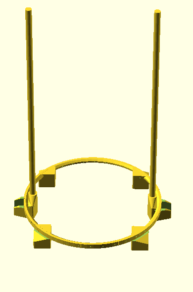

This is the start to Ring Rap openSCAD. So far we have a way to change out the cross section of the rim, a standard way to specify rim size (using ISO diameter, as that is the best way i could find), Specify spoke number and hole size (will add taping holes in the blocks.
I am structuring it so that all variables for the printer are stored in one file, so you don’t have to mess with finding hard coded numbers… although there will be some.

I think you are referring to the amount of plastic on the vertical pole. That distance is parametric, currently it is set to 100mm, and the legs are set to 70mm, it is possible to change those to any positive number.

Will do… currently this would be the base. (it has alot of extra print material that i need to remove) When i make that part i will make sure to make that distance variable, along with several others.
Oh, one really cool thing i built into this scad model (that i don’t see in the original ring rap files). The bike rim spoke holes are “drilled” into the part. Every part is placed on the rim at a specific angle, So when you mount it to the rim (using screws) you will get perfect alignment every time you assemble it.

Second i did a commit with the new “Test pieces” i need to do some testing to make sure the code actually works well. but for now it is on git. The STLs for some example test pieces are now on git. The profile is that of a random rim i found on the web…
Updated, also reduced the foot height to reduce print time (no need for 40mm of extra plastic, i think it will reduce it even more however), Added nut traps, and bed holes for the bed leveling screws. And added instructions to the SVG to walk through how to make a new rim contour.
