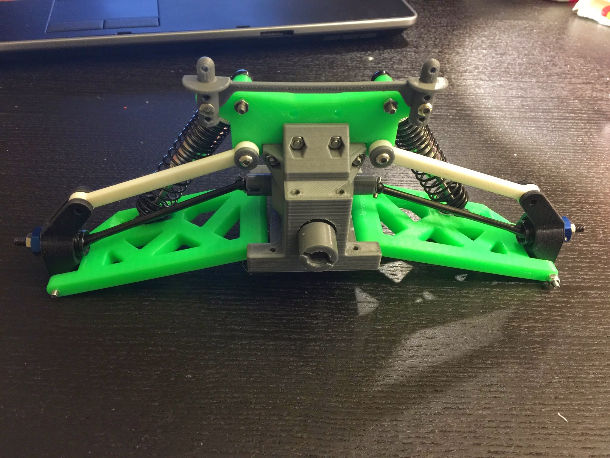

This is very close to working.
This is very close to working. I purchased the CVD’s from Hobby King:
Front CVD - 1/10 Quanum Vandal 4WD Racing Buggy (2pcs) PRODUCT ID: 382000124
Blue Aluminum Wheel Adaptors with Lock Screws - 5mm (12mm Hex) PRODUCT ID: 151000031
I think I could make it work with a longer axle shaft. Does this sound reasonable? Not sure I want to shorten the wishbone since I just printed them in carbon fiber pla. (Not in the pictures).
I ordered enough of these to make 2 RC cars, but if someone has something that works that I can purchase please let me know. It would need to be shipped to the United States, so Conrad is off limits. :frowning:

What did you end up using for the rear cvd’s?
These two items:
and these 6mm longer than normal:
Great - thanks for the help. So the front CVD’s end up being used for the back too then?
Yes. Not sure if you have seen my other post.

I also made longer axle shaft covers.
Thanks, this is very helpful. I ordered the wrong ones before and now these suckers are on back order. Crossing my fingers they stock up soon on them.

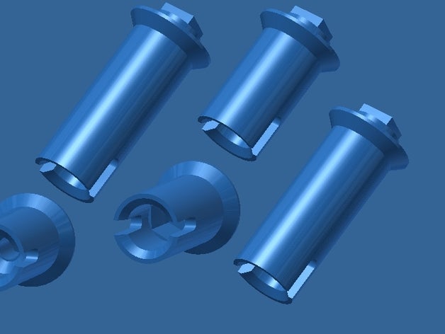

|Hey so am I right in saying that using these CVD from hobbyking and this http://www.thingiverse.com/thing:713316 they work fine with no other mods?? thanks for your time!
