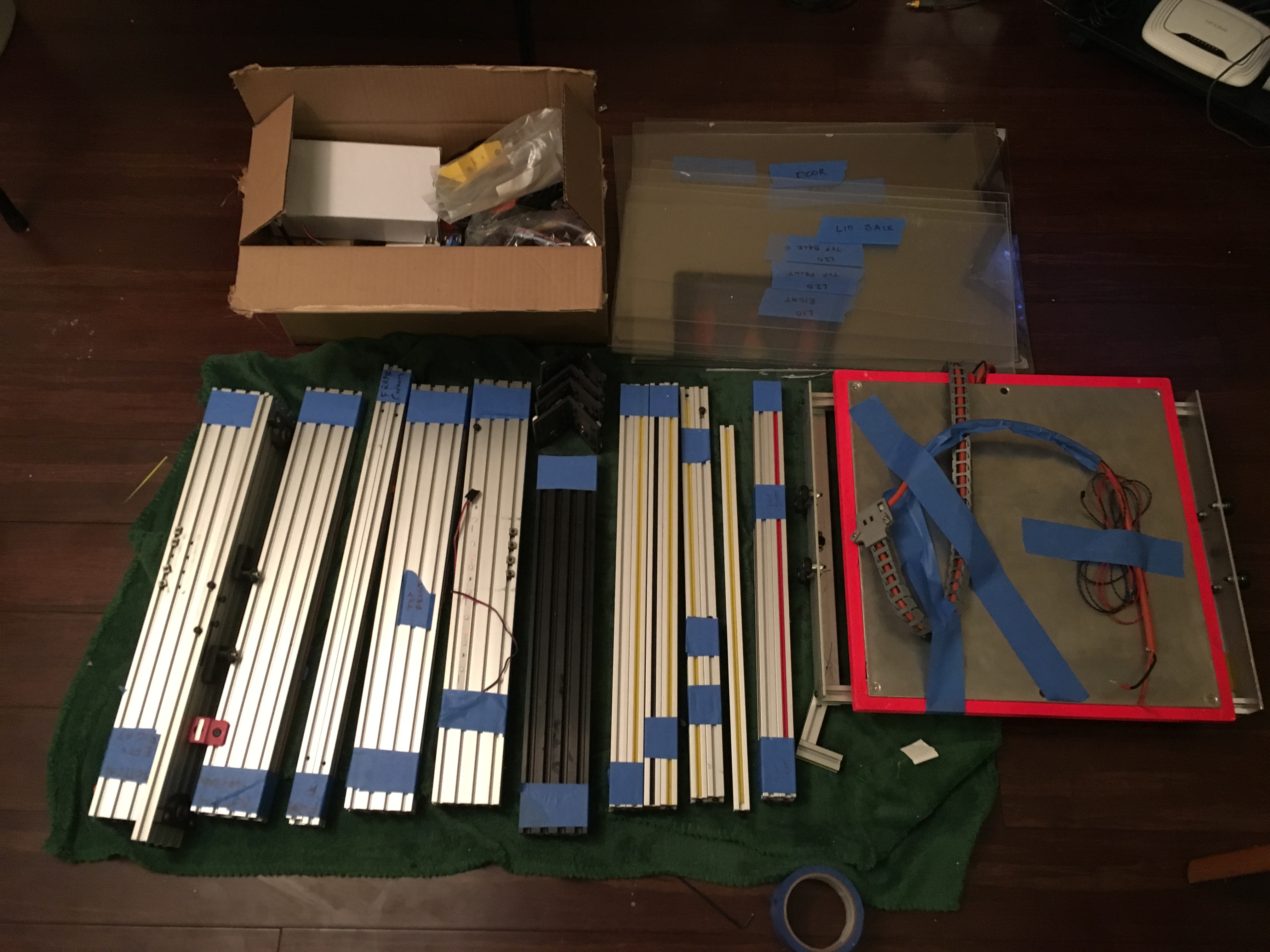

this is what an entire Herculien build looks like after disassembly and arrangement into grouped components. If anyone is interested I’d be happy to document my rebuild with pictures and comments as I go through the the process from individual components, to alignment, break-in, and tuning.
That would be a much appreciated documentation.

@Jim_Stone As I was taking it apart I was devising my strategy for re-assembly. I think I have it figured out now. But @Eclsnowman has done it more times than I, so his insights into my future posts should shed some light on it all. I’m approaching it with new knowledge now, so I think I can provide useful comments and suggestions as to the approach.
