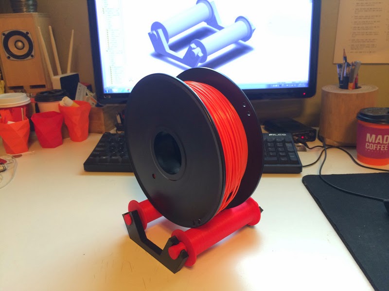

This is what I made today.
A universal spool-roller using 608 bearings and can be assembled via screw & snap-in pin (no bolts and nuts are required). It consists of two roller units and stand. And it can be used on various platform upon changing design of stand. I think it can also be used with one roller-unit centering hole of a bobbin(like many designs for prusa i3).
#spool_holder, #spool_roller
it’s nice, but it there is a risk of skinny spools toppling over.
I’d be tempted to add a tapered shape towards the middle so spools will ‘self center’ after they turn and not drift off to one side if something isn’t even.
Like the rest of the design.
@Electra_Flarefire is right. Might want to add a way to recenter the roll.
@Electra_Flarefire It is good idea! I haven’t thought about it. Thank you for comment
It might act more like a belt on a roller, where as the middle is a larger diameter as the belts"climb" the incline. Goggle it for a better description:)
