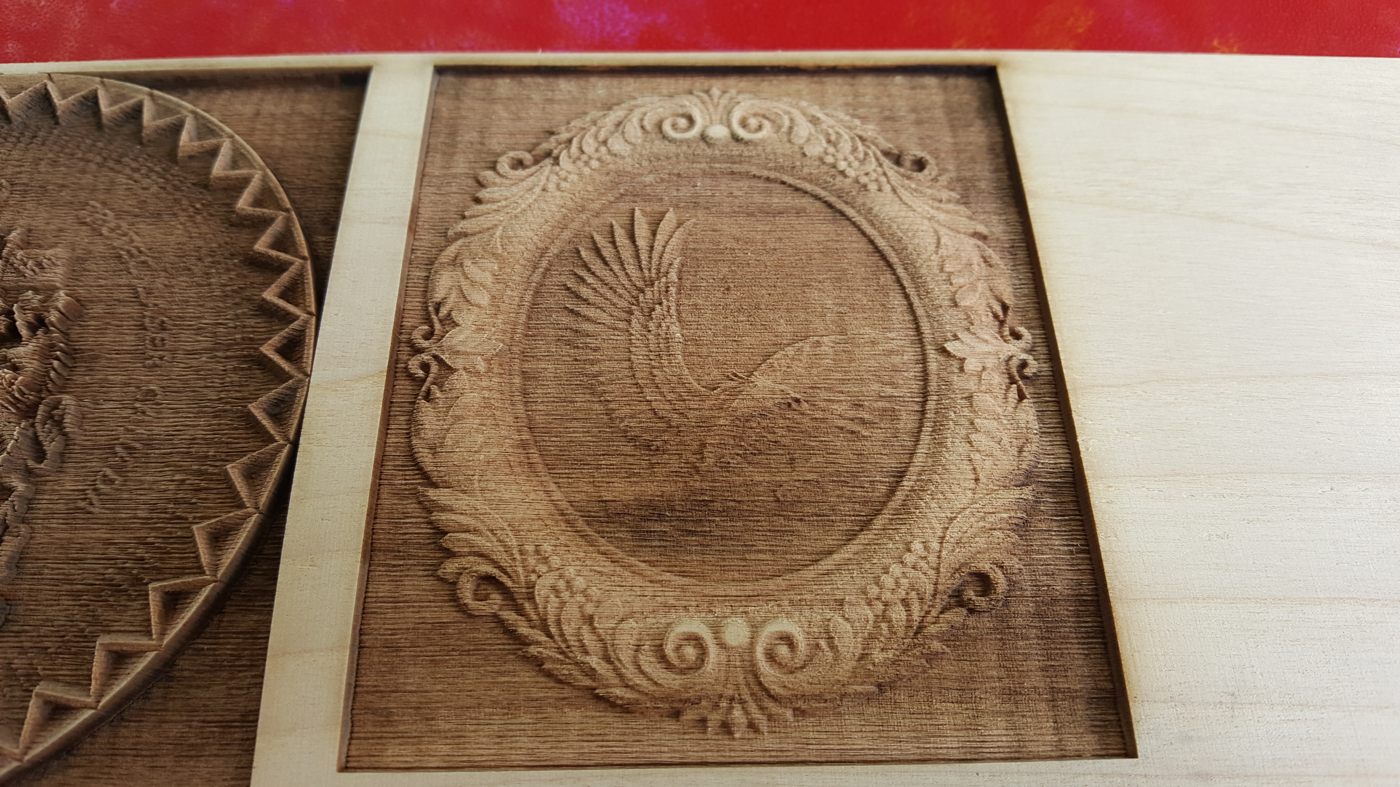

This is what it looks like with one pass only.
I did get something similar to that at one point, but when I say similar I mean “please Scott stop you are making me feel bad” type
@Ariel_Yahni_UniKpty …lol…sorry.
so your max burn depth is 3/16 or so ?
What focal length ?
Oh and Awesome !
@Todd_Miller …I’m using a 1.5 inch hd lense right now…I’m gonna try a 2 inch tomorrow and I’m gonna repost the results.
@Todd_Miller …the depth is determined by how many passes i do.
Hi Scott I realise this may be a dumb question, but does the size really matter
Lens I mean. How are you using different lenses. New laser head ???
@Tony_Schelts …yes shorter focal lenght is a smaller dot size…so its better definition on the work.
