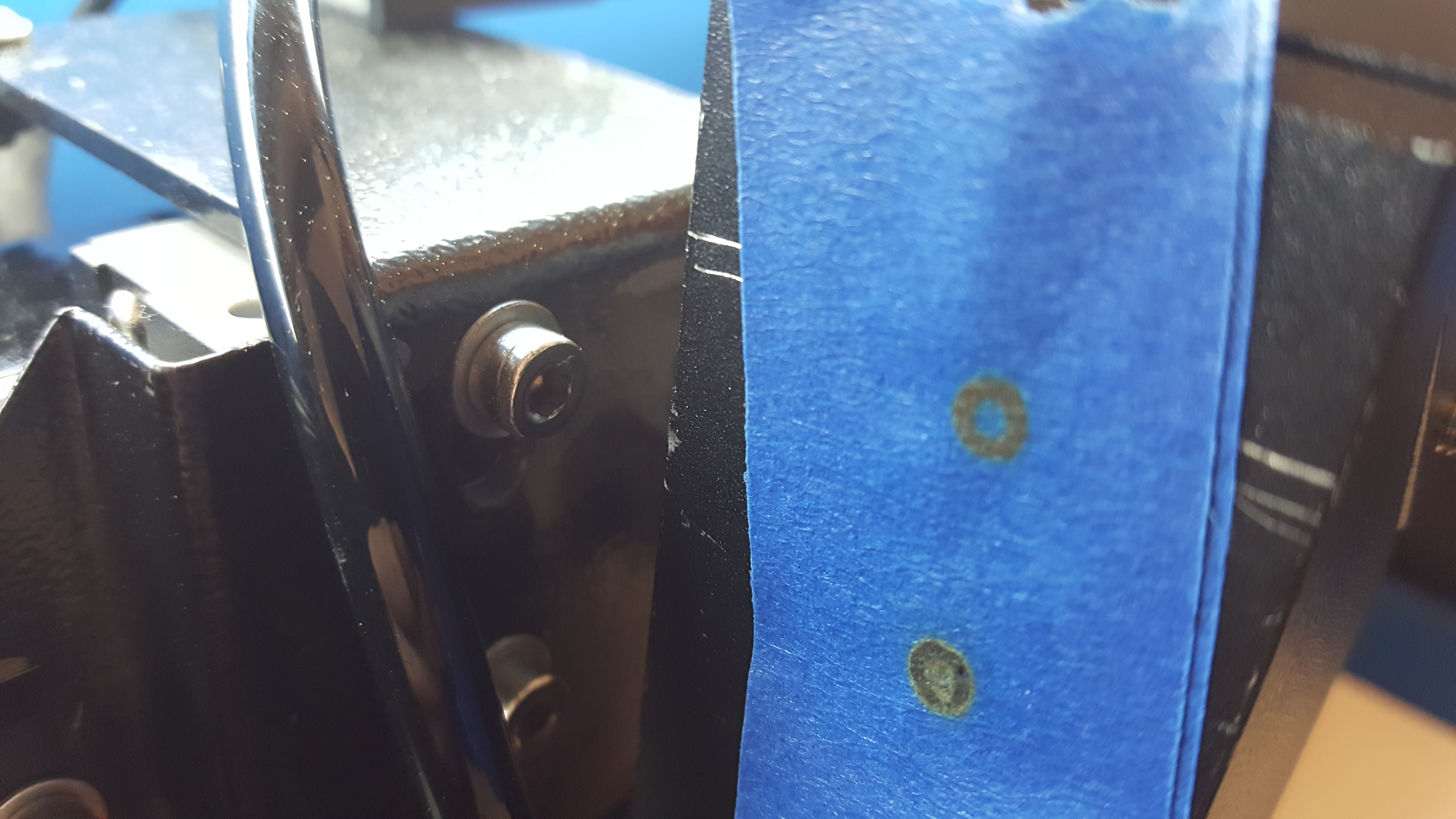

This is what the beam looks like at 12% power…I’ve never noticed this before with the other tube…or the k40 that I used to own…any thoughts anyone.
It’s almost a perfect doughnut shape. What is the lowest power you can shoot at? I’d be interested to see the difference in beam shape for different power %s to see if the dead-spot increases in size at lower powers or at higher powers.
I’d expect the elements in the laser tube are out of position, causing exactly what Yuusuf described, only in the tube optics instead of the head.

@Yuusuf_Sallahuddin_Y …that is the lowest power setting that it will fire at…
12% power.

@Scott_Marshall …I think you guys are right…nothing I can do about it…I’m gonna run the mess out of until it quits them reinstall the reci tube.
@Yuusuf_Sallahuddin_Y …at 20% you can’t see the dead spot at all…crazy right.
In the tube there are just two mirrors…one fully mirrored and one 90% mirrored…I think that is correct.
@Scott_Thorne That is odd that increasing the power removes the dead spot. So I guess, just don’t run under 20% haha.

Looks like your laser is running in TEM01 mode instead of TEM00-https://en.wikipedia.org/wiki/Transverse_mode
Unfortunately that kind of operation is inherent to the optics in the tube (primarily Brewster angle of end plates), so you can’t do anything short of replacing the tube.
