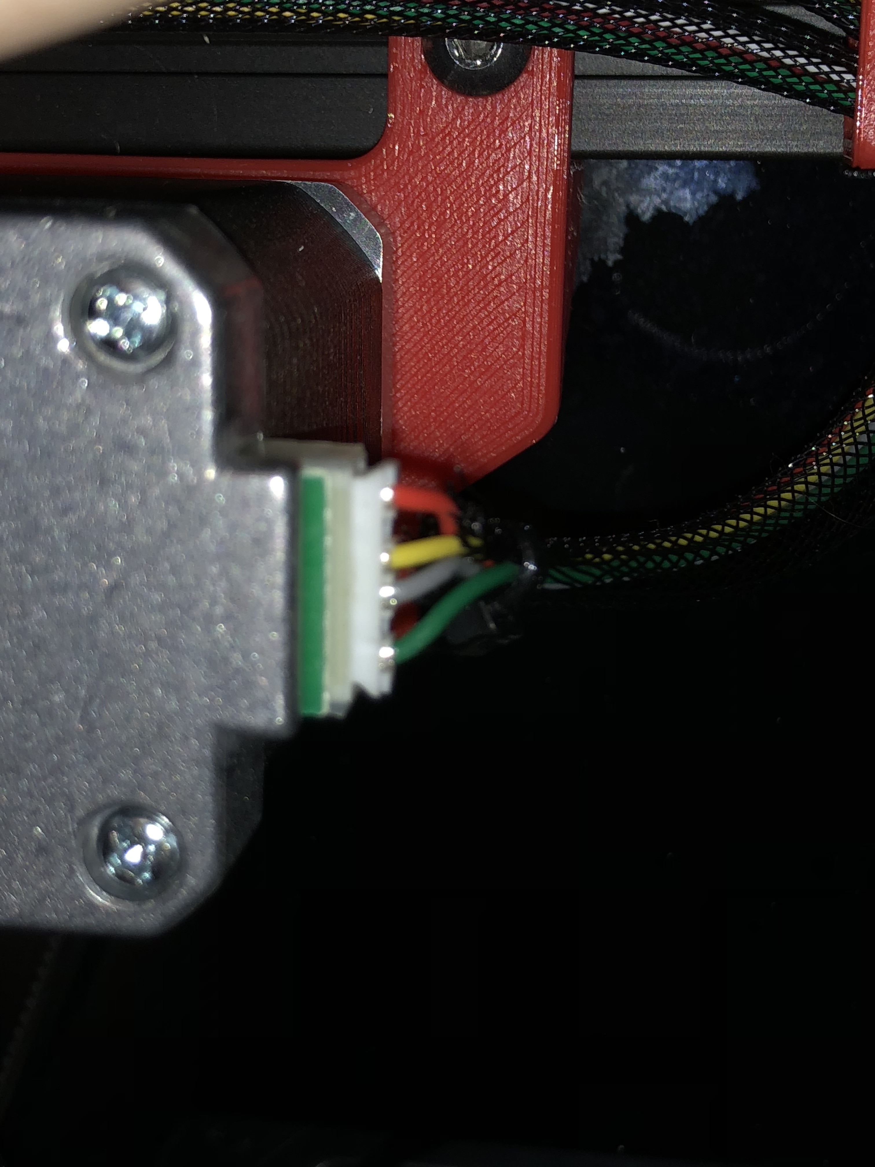

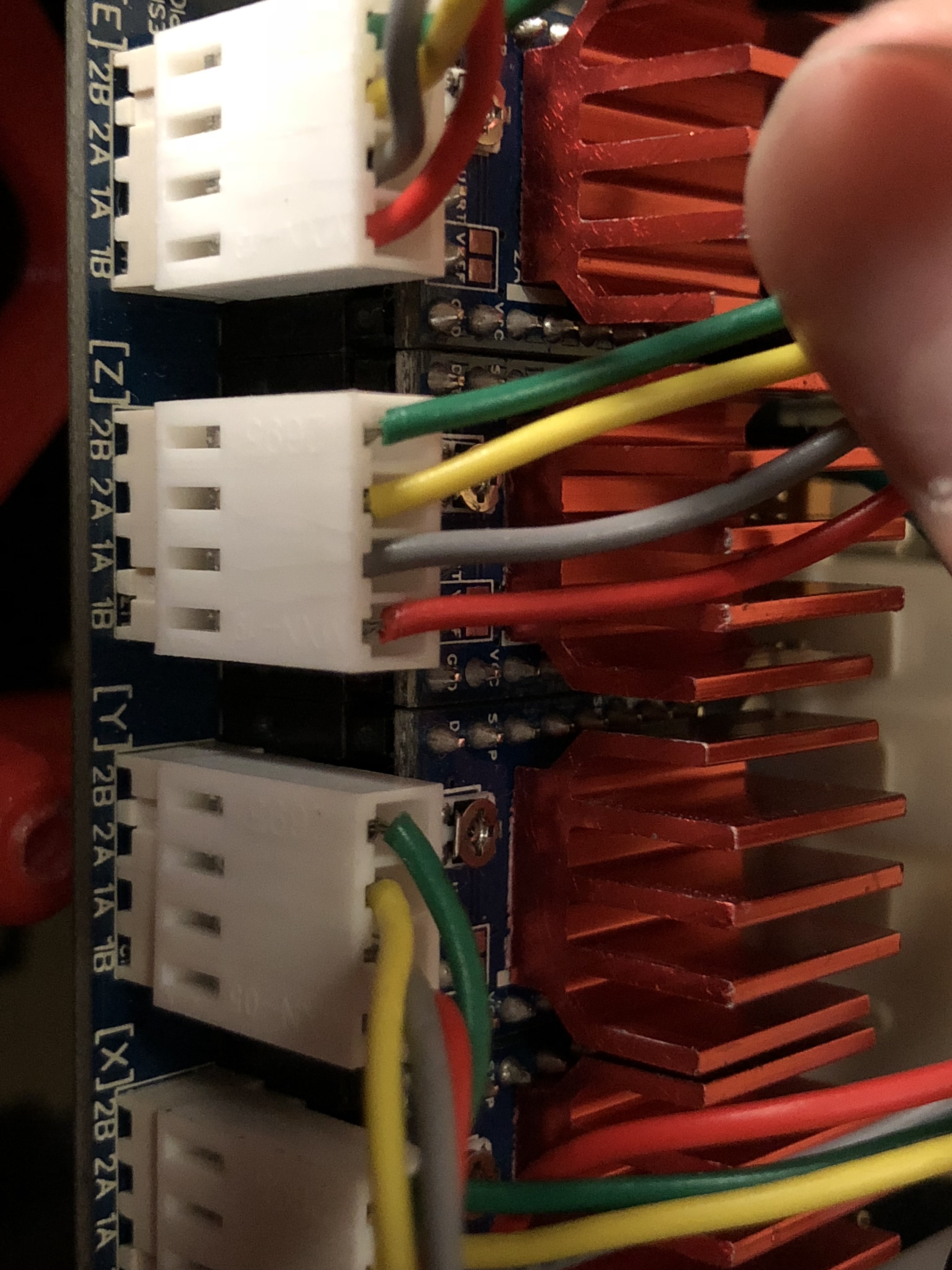

Well. It started to work. I don’t think my Z axis is moving at all.
I made some changes via the X5mini WIFI interface. Does this override the config.txt file? Do I need to reboot after making changes?
So what is the actual current to the steppers:
alpha_current 1.0 ## 0.65 # X stepper motor current
beta_current 1.00 # 0.65 # Y stepper motor current
gamma_current 1.5 ## 0.75 # Z stepper motor current
Are they set at 1.0 and 1.5 or .65 and .75?
I’m asking because my Z axis just whines when I try to move it up or down. If I home Z it seems to work sometimes.

I don’t get it. I can move the Z around in the EPS3D for Smoothware web page off the X5 Mini but not in Simplify3d. I can home Z in Simplify3d and EPS3D web page.
are you sure your steps/mm are set correctly for Z?
I have the Z set for 1/32. I think in the past I have always used 1/16 which is what I started with. Do I need to set this somewhere else for 1/32?
@bcrazycramer If you are running 1/32, when you were previously running 1/16, then you would double your steps per mm in your configuration.
