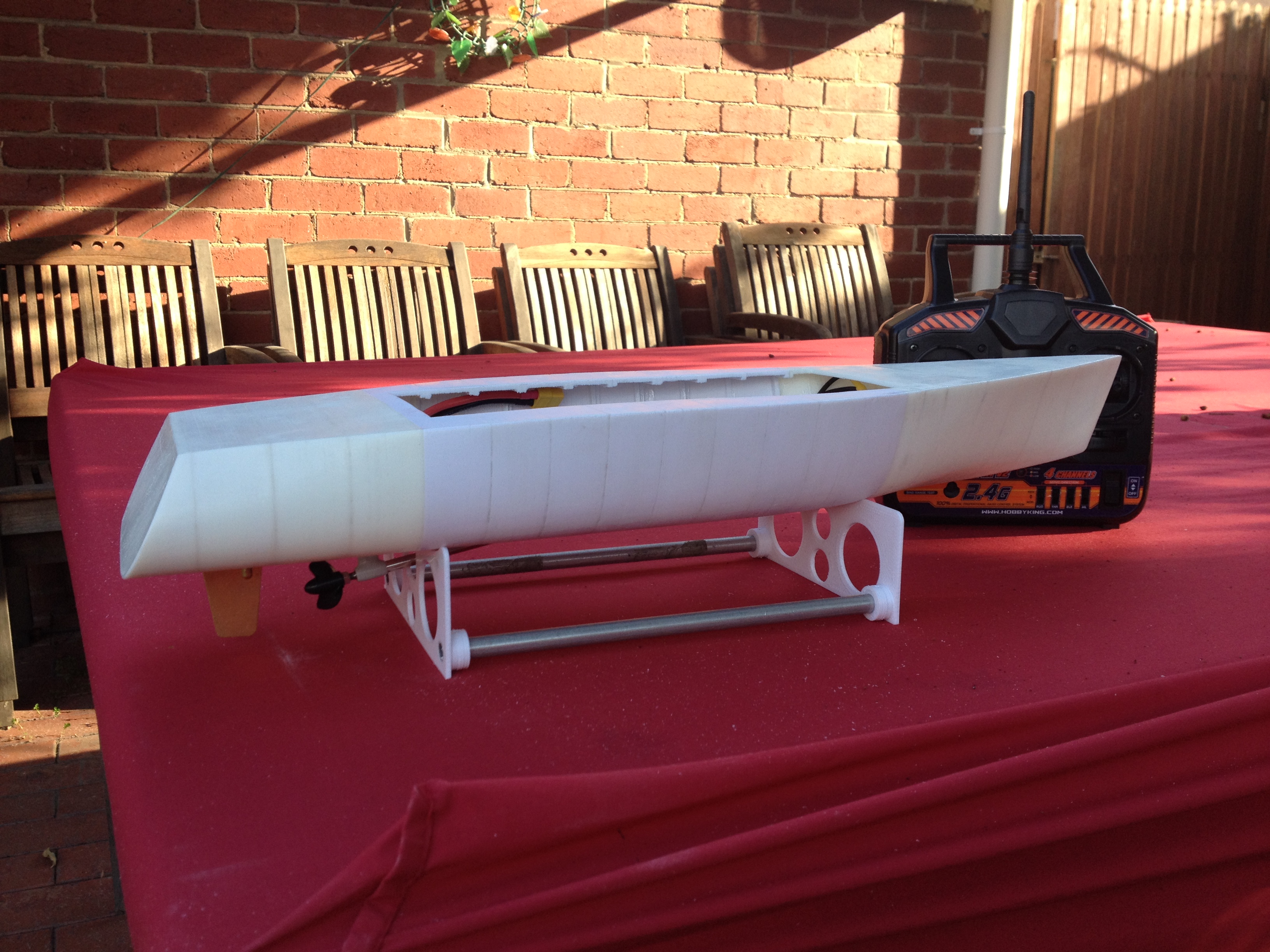

This my first 3D printed model boat.
This my first 3D printed model boat. The hull shape was designed using Delftship and then the 3D design was done using the desktop version of Autodesk 123D.
It was printed on my home made printer. The hull was split into 20 sections each 30mm long to yield a 600mm length of all. All up weight is 1kg fitted out.

Nice, what are the print material and how did you join them?
It’s printed using ABS and glued (or welded) using a mix of ABS and acetone. Next time I’ll include locating pins in the design to improve assembly process.
