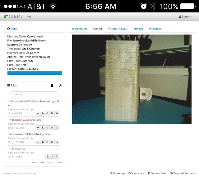

Finally woke up to music to my eyes. (Well, OctoPrint doesn’t carry sound so music to my ears remains elusive.) World’s first Ares 3D scanner’s laser bracket printed on Ares 3D printer! What a world of difference the correct firmware has made.

With this renewed confidence that any print will finish without fear of being knocked off bed, I decided to give this bracket another try. Not from the 90º rotated orientation, but from the flatter orientation as posted by the EasyArts.
There still is significant unevenness in the bottom layer, but that is more a bed leveling issue that can be adjusted. The piece really sticks to the bed. You can also see obvious defects in the front wall but that’s the only big surface defect in the entire piece. (Aside from the bottom.) The problem is in printable area. The total length in the arm is 149mm, while the printed object is a millimeter or so short, so Ares didn’t get to print an outer wall. I hope this will not affect the function of the bracket.
All in all, this is a good piece.
