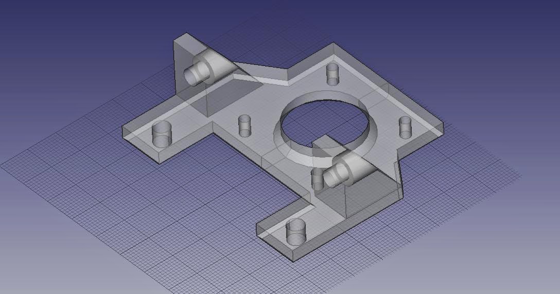

This one wan’s easy (for me
)… but another model in FreeCAD
Great work.
Thanks, at the very least I’m learning how to Model.
Nicely modeled!
Do you have the option to fillet the edges? You can add significant strength to parts, especially at 90 deg corners if you can give them a slight fillet or chamfer. (Many of the Eustathios v2 parts have the edges I mean.)
I’m having some issues when I tried to fillet the model, but you can notice the chamfer on the bottom part.
In some CAD software, you have to split parts up, fillet, then recombine them if it can’t figure out all the edges of a complicated part.
A blind hint, I haven’t used freecad, but it may be worth looking at workflow-wise.
Normally my questions are about what are the best practices. I’m guessing that I will have to redo everything to be standard in the way I’m modelling. For the time being I’m just doing what comes to mind first.
@Jim_Wilson I can do some fillets but the software gave some errors and I gave up. Perhaps I will try another approach.
I’m using freecad because I like the Open-source ideology and I’m using Linux
(because I like the Open-source ideology)
Fillets only help structurally on concave corners. The rounds on the convex edges are just there for appeal or to cut down on rough edges.
Here’s my version of the exterior XY Motor Mount: http://i.imgur.com/KNjosh3.png. I added some exterior fillets for appeal, but the interior ones are important, especially considering how close they are to those extruded bits.
And because detail is free! (unlike, you know, working in wood…which is why I was never good at working in wood.)
