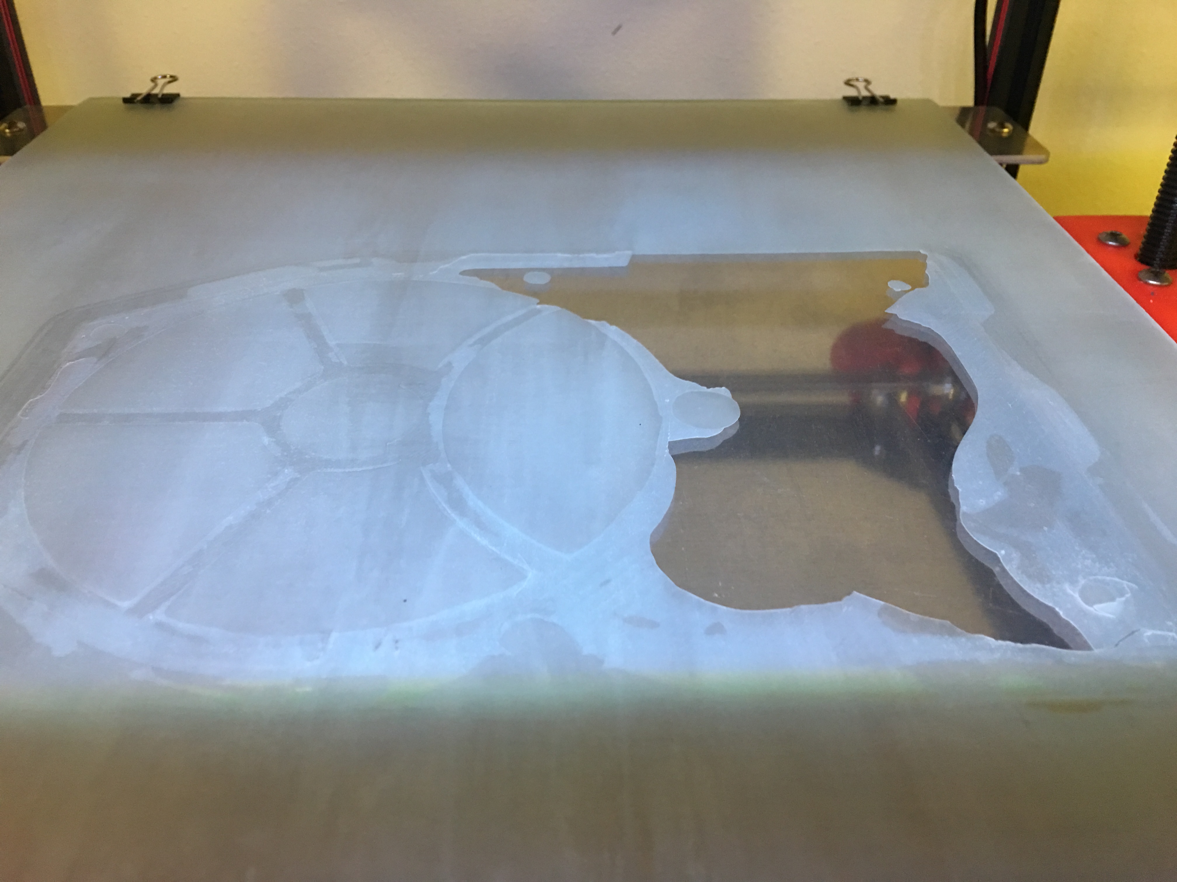

This seems to be a thorn in my side. This happens to me every time I apply the 3D-EEZ film. This time it’s really bad. I’m posting it on here hoping more people will see it and have recommendations.
I cleaned the glass off with soap and water and scrubbed the heck out of it to clean it off. I wiped it dry and let it set for a bit. I applied 3 coats of film alternating directions every time with about an hour between coats.

Is that during part removal?
Yes that is what happened when I removed the part.
Try a little bit higher from the bed in the nozzle height (less squish), and a little bit colder on the bed temp. May just be bonding too well. Also as mentioned clean with acetone or alcohol first (or window cleaner), then apply to the glass.
Yep, have to clean with alcohol. For a big print I’ll let the bed cool a bit to help the release. Also have a flat metal spatula 1" wide to help start lift. But even on a stubborn removal, never had the surface pull off like that.
