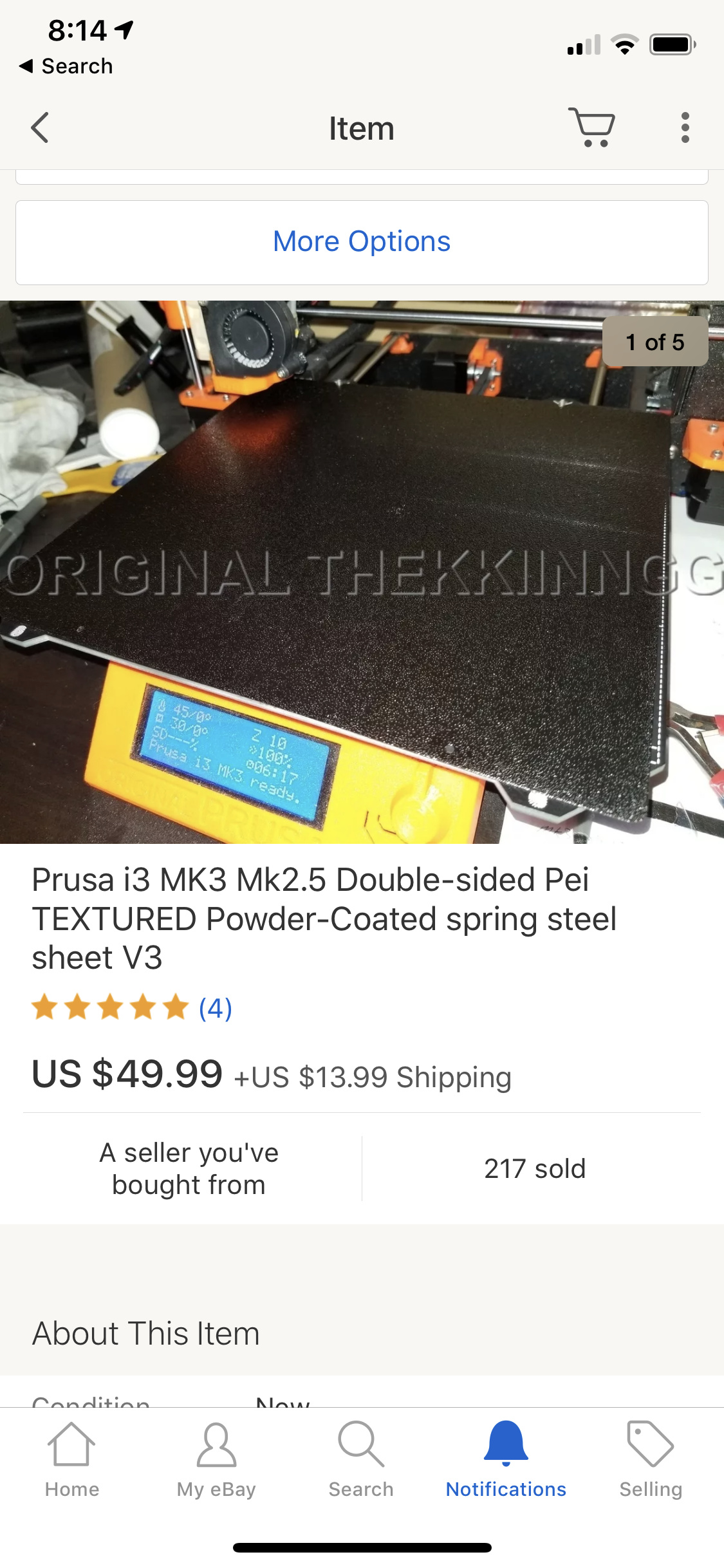

This seller may be able to make custom beds for the Eustathios! I have one for my prusa, it’s awesome no talc needed for petg

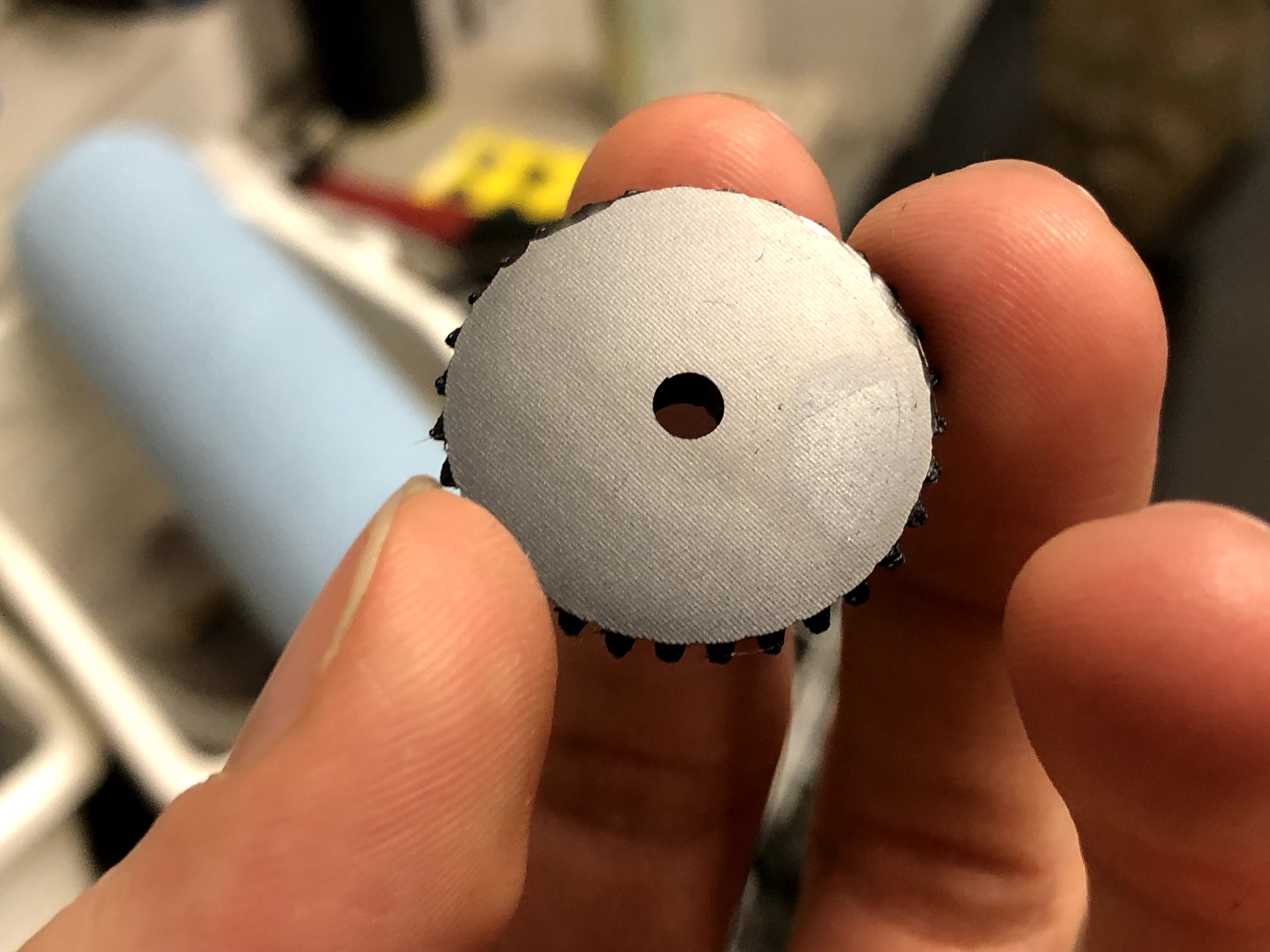

Talc to reduce adhesion so the PETG doesn’t weld to the PEI, I think
I’ve never needed to do anything special other than use a lower temp. 65°C seemed to work fine.
@Ryan_Carlyle yeah sorry for being unclear I use baby powder on my pei so PETG doesn’t bond at 90c also no warp
Can’t find a link to the seller. Maybe because I’m on mobile?
