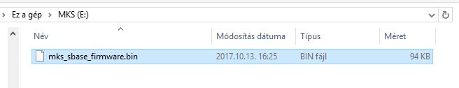

Which file should I copy over the micro SD card?
mks_sbase_firmware.bin and config
@Tom_Toled Download the “mks_sbase_firmware.bin” from my github page https://github.com/cprezzi/grbl-LPC/releases/tag/beta08_4axes and save the file as “firmware.bin” to the sd card. Then reboot the MKS board.
grbl-LPC doesn’t need a config file on th sd card as the configuration is mostly done by compile switches already. All other params are configured over the serial connection with $ commands.
Be aware that the endstops need to be connected to the X- and Y- connectors, no matter where the switches are located. The homing direction must be set with $23=…
I solved the problem.
Thanks for your help !
The upper screenshots show, that the firmware flashing didn’t work. If it worked, you should get “Firmware Grbl 1.1f”.
