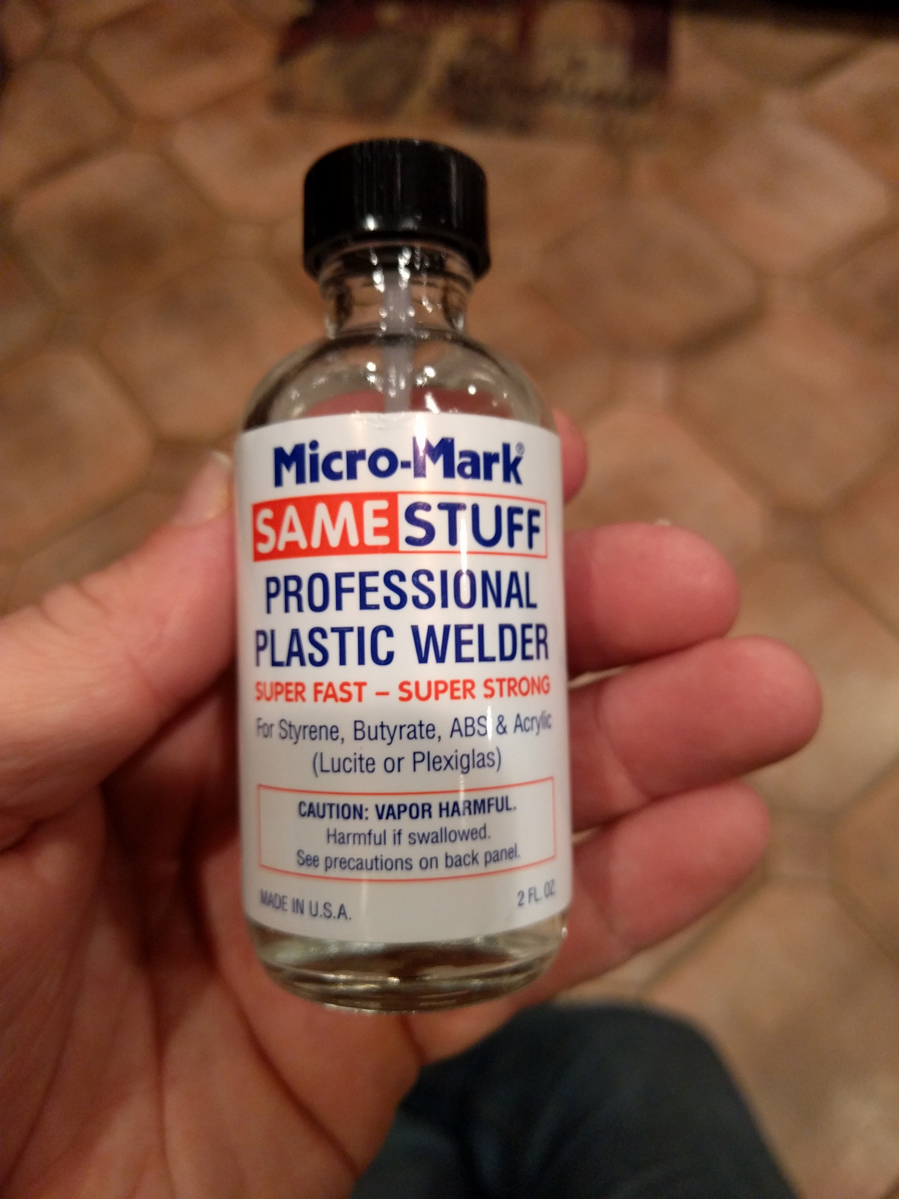

This "stuff" works great to bond ABS seams together!
This “stuff” works great to bond ABS seams together!
Plastic Welder huh?
Well do a comparison of that with normal 2 part Epoxy?
Yeah… And it’s cheap. Only like $5. Found it reading through a stratus bonding guide
Tenax will work too. It’s plastic solvent. So it melts the plastic so the prices can be joined.
I just use acetone.
What chemicals are listed on it?
ABS solvent welds pretty good with acetone already. Do you have an opinion on how it compares?
http://www.micromark.com/same-stuff-professional-plastic-welder-refill-2-fl-oz,9002.html
That’s so cool!
That is suppose to be able to put a slight finish on PLA prints also.

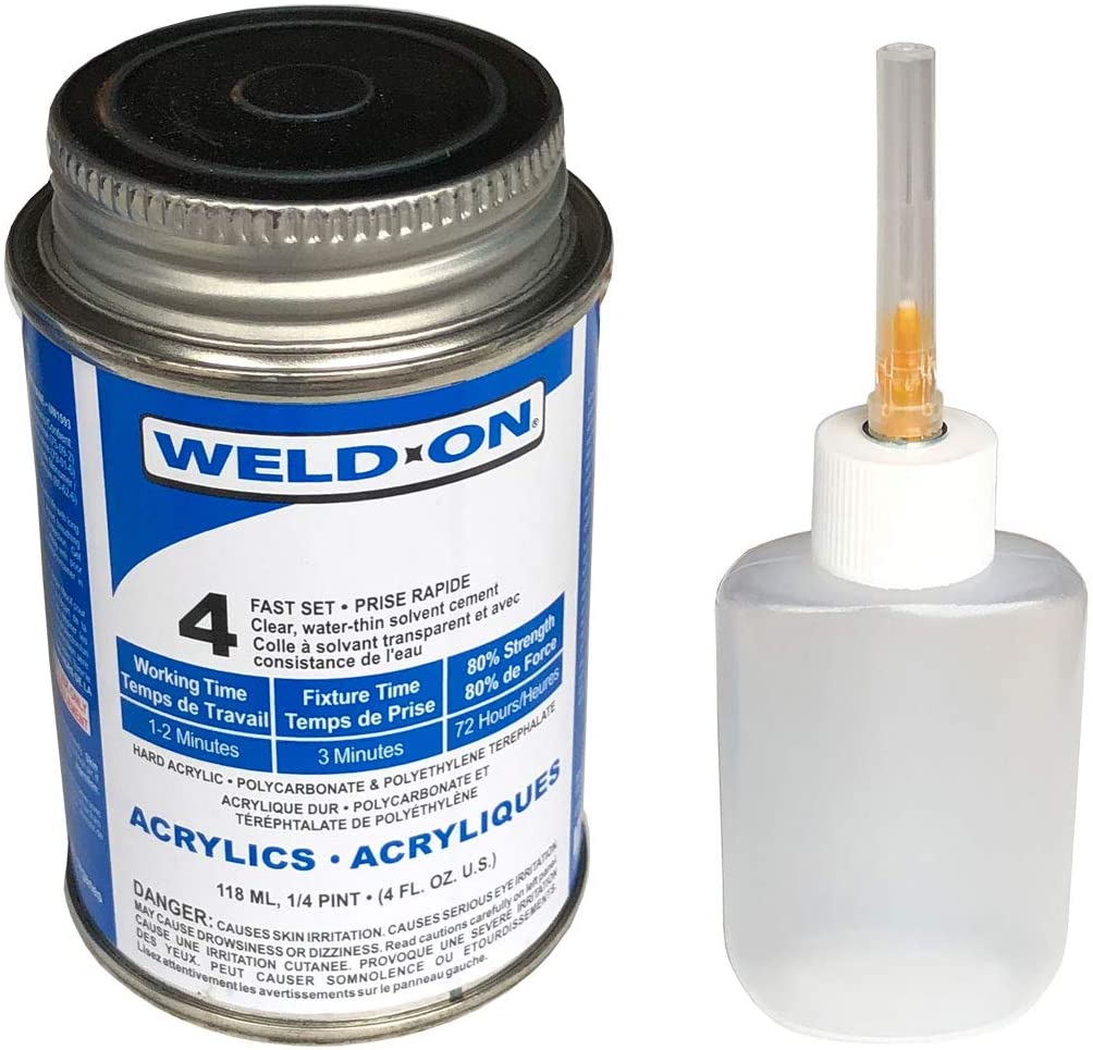

I think this is the same as Weldon 4 http://www.amazon.com/SCIGRIP-10308-Acrylic-Solvent-Water-thin/dp/B00JFPF0UQ/ref=sr_1_1?ie=UTF8&qid=1457674966&sr=8-1&keywords=weldon+4
or
which admittedly works great, but people have strong concerns about the involved chemicals

Its probably dichloromethane the same thats in Tenax. But its all about PEL limits. Unless you huff it or work with it 8 hours a day, your exposure level is probably minimal. THF will melt ABS, and PLA, and may be a safer bet. You can use ABS pipe glue.
http://www.oatey.com/msds/sds-us--oatey-abs-special-milky-clear.pdf
Looks like MEK will work too. Less volatile than acetone.
Gotta say not sure whats in it but just applied like some nail polish and the pieces stuck mint. Think you guys are over reacting just a little… this is made for hobbyist . Just don’t take a big hit off it and you will be fine.
