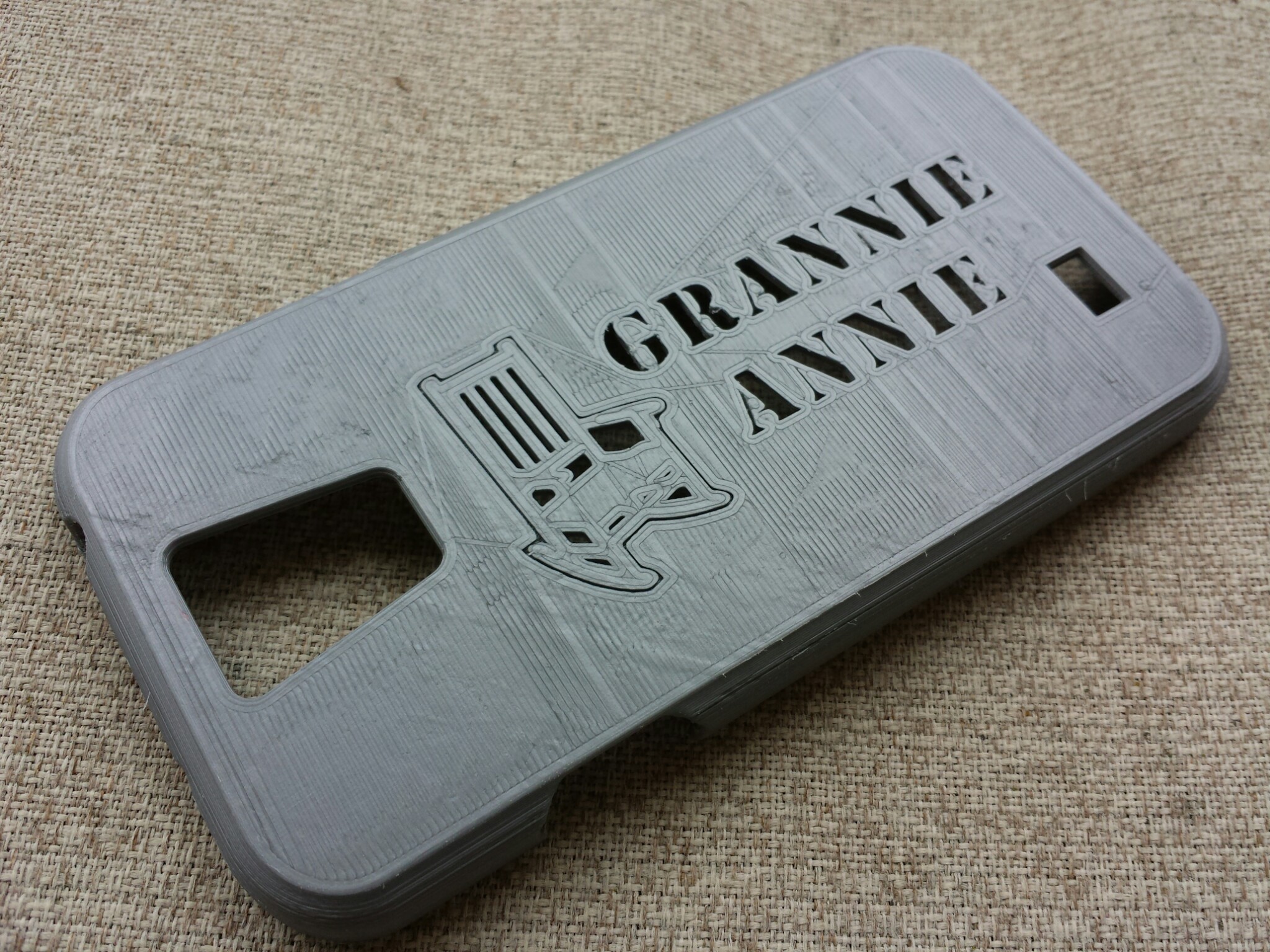

This was a request from my mom to give to my aunt who is now retired and recently a grandmother. I had to learn how to do boolean difference in rhino to cut things into an existing cell phone case blank from thingiverse. The text actually made this one of my most difficult prints yet. Took lots of tuning and aborted prints after the first few layers. But it was fun finding a way to represent a rocking chair using a combination cuts through the case, cuts partially through and then bridged, and utilizing the infill pattern to approximate the rest.

@Shauki acceleration is set at 9000mm/s2. Speed was pretty slow. 25mm/s first layer, 35mm/s on the rest of the back, 70mm/s on the sides of the phone. That’s one nice thing about Simplify3d, You can set different parameters at different locations in the model. I guess you could always spice different gcodes together, or hand edit to get the same affect.

The biggest advantages of simplify3d in my mind are support generation, different settings by layer height, and slowed outermost perimeter for better surfacing.
