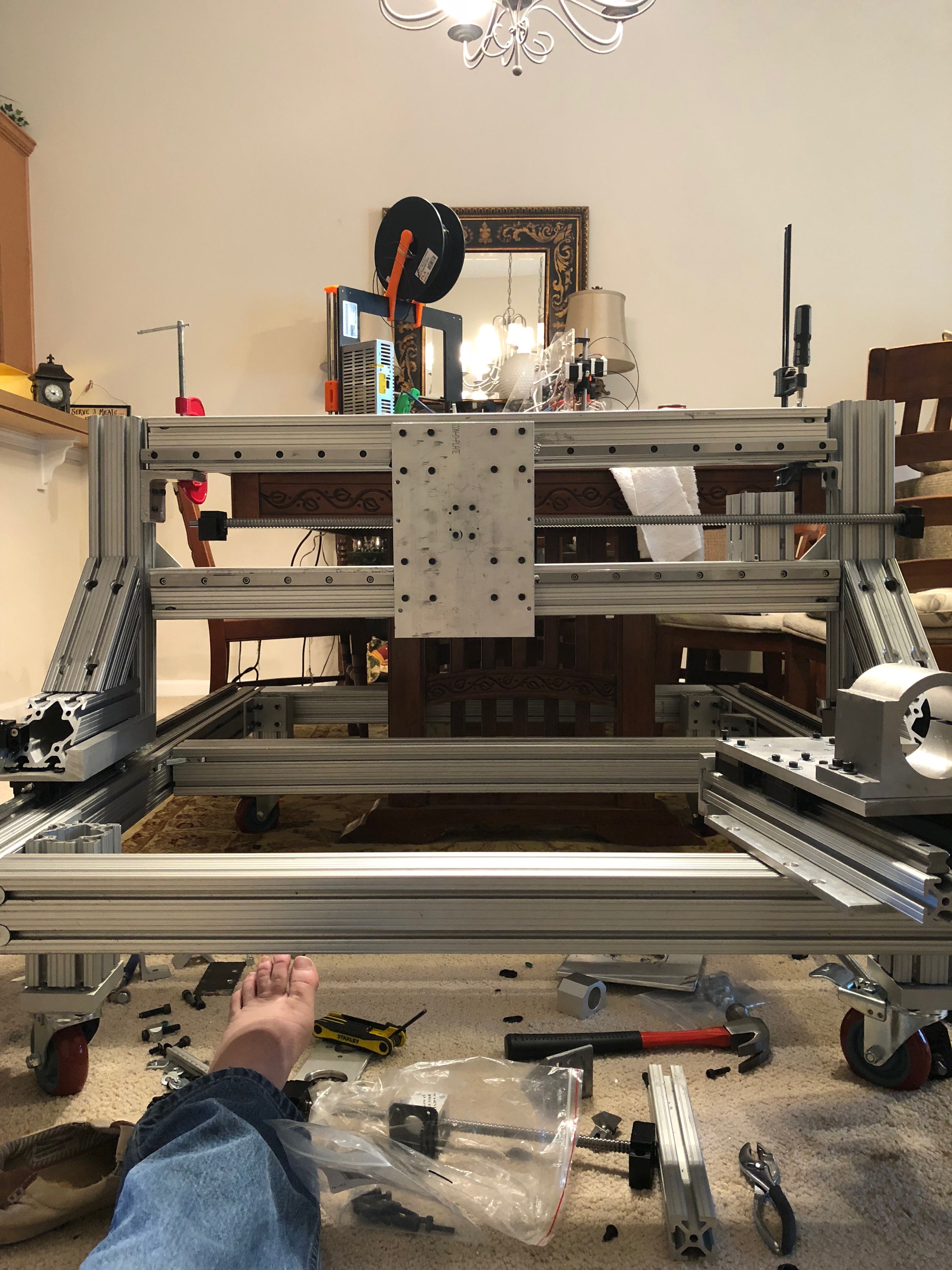

This wasn’t my original design, but I hope I can make it work.
What a beast
@Dale_Royer But can I get her to work?missing/deleted image from Google+
I believe. What motors are you going to be using?
I think that’s more functional missing/deleted image from Google+
I agree
I will be using a Nema 23 with a gear box for the x-axis, a Nema 34 for the Z and 2, 425 oz-in Nema 23s for the Y
Awesome. I definitely support the twin motors for Y. I have dealt with racking on mine using a single motor. Not fun.
I only have about 4.5 inches of z axis work room for this now. But I built it so I can switch out the z axis gantry beams for longer ones, when needed
Are you planning on a 4th axis? Given general bit lengths, 4.5 inches seems like a lot.
@Dale_Royer eventually, if I can get it running reliably
You need to get the full length of your ball screw mounts (as precise as possible) and probably build custom mounts. This is where a 3d cad would come in handy
