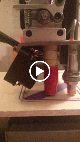

This week I upgraded Cura & CuraEngine from 14.12 to 15.02 and ran into some odd, frustrating behavior when printing first solid layer & infill that I was hoping the community could explain or help me address.
I kept my cura configs & settings the same between 14.12 & 15.02 and am using the exact same STL files.
Cura 15.02 started making my printer print solid layers and infill in a very jerky fashion, by printing one line, then lift up the hot end and move it to the next postion (often a fraction of a mm over), then lower it and print another line, then lift again, move a fraction ,etc. It doesn’t move in a continuous, zig zag motion like I get when I use 14.12.
Anyone else seen this? Any help or tips are greatly appreciated

can you disable optimizations cura make ?
Check your Cura settings for newly added ones with a default that does not fit well with your machine. Sometimes these creep in with new versions. Particularly check for a Z-lift setting.

The “Combing” option in expert settings changed between those versions from a checkbox to a combo box. Set it to “Enable Combing: All”

@Nick_Winters That’s the fix, thanks a bunch for the tip!

Looks like “Z-lift while retract” combined with “retract when crossing perimeters” to me. I have no Cura, but Slic3r and these are the options in Slic3r to get the “hickups” :smiley:
