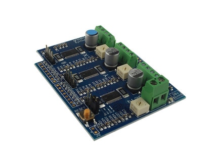

The grblShield from TinyG people works fine, but there are others on Aliexpress, from Protoneer in NZ, etc.
