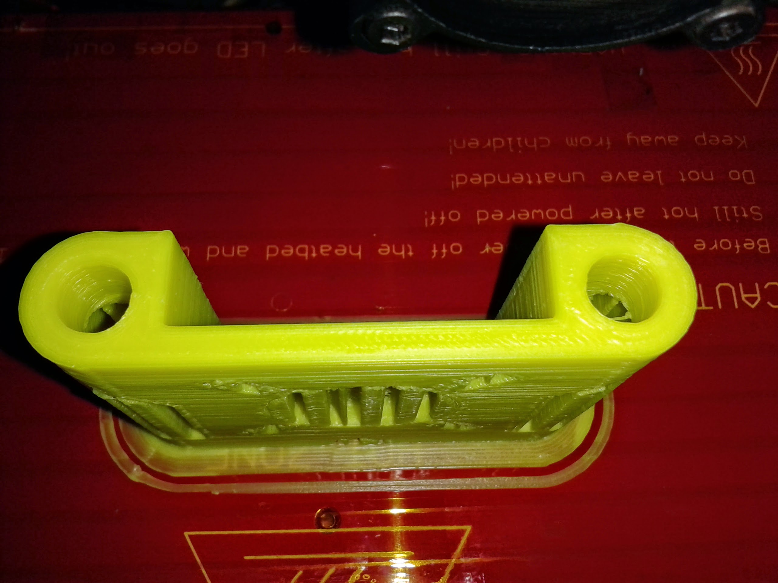

@Thomas_Sanladerer it works great now, it can actually finish a print without shifting at the end. And it’s way quieter. In the pic the difference in height on both sides is around .2-.5mm and the re aligning of my z axis helped a lot.
Now I can start pumping out kits again :smiley:
Oh and I forgot to change my Slic3r settings so it was printed with support as seen by some of the jagged edges around the holes.
Gratz. Nice lookin print.

Those parts look pretty good - glad I could help.
How did you fix the issue? Did you only realign your z axis or was there more to it? I only ask for anyone else who encounters similar problems.
@William_Warren Mainly what I did after failing to attempt the heated bed straight on the aluminium plate was to just go with the Spring loaded heated bed on an aluminium plate with NO Glass and NO frog plate.
This lightened up the Y-stage quite a bit. Re aligning my Z-axis was a must as my prints had a slight angle to them and it was bothering me. I also re aligned the Y axis smooth rods.
