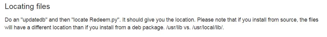

those savvy with programming please help. I need to SSH in to the BBB so I did and was able to use debian for login and temppwd for the default password. is there anything else I need to type in before I can do “updatedb” ? how do I locate redeem.py?
yes, but remember to do make install if you modify the sources there. The code isn’t run from that location.

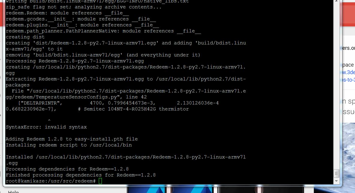

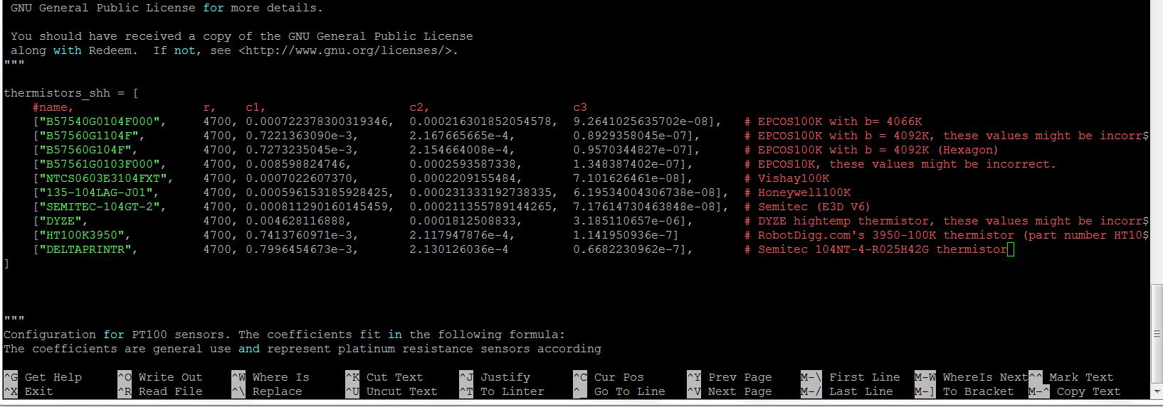

ok did nano and added a new line I call it “DELTAPRINTR” all c values taken from steinhart calc.
so I’m not quite there yet? what do I need to do “make install”? sorry I’m complete noob here

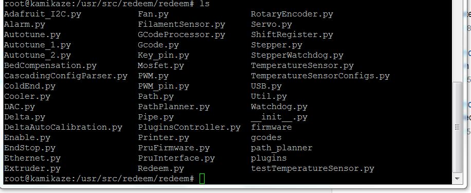

you only added it to the original source files, not the actual code that is run. execute ‘python http://setup.py clean install’ in the redeem folder
Which redeem? The top one?
haha Semitec-104NT4 found the steinhart coefficient here
http://smoothieware.org/temperaturecontrol#toc5
I think I will change my values to follow the number shown there.
