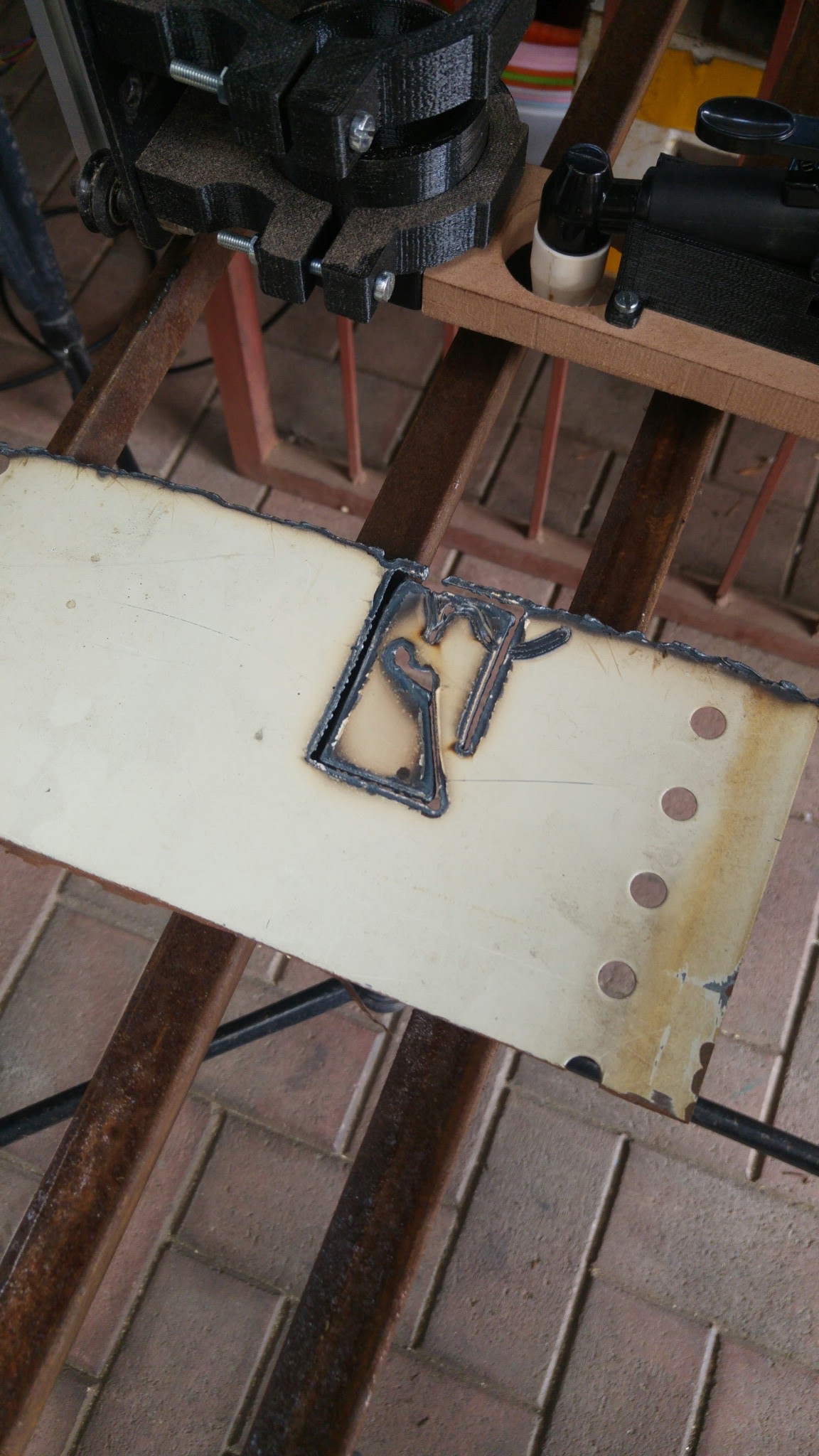

Heres the holder there are 2 mounts I made one bolts onto the plate the other which I hope works well just clamps into the spindle mount. Obviously the wasteboard comes out and I’m planning a simple aluminium frame to hold the steel work bed and water catch tank. I find myself thinking so much faster than I can build that its frustrating. I barely have the cnc up and running and already I’m modifying it for plasma.
Mixed success. Worked right upto where the arduino stopped responding half way through the cut. I was manually pressing the button on the torch. But in all this is a a cut done with laserweb. The half circle was meant to be a full circle. And it starts from a point where the paint is chipped on the metal. I suspect that emf you spoke of is the culprit. Any tips on shielding.
OK so some work to do.
Would ferrite chokes help ?
