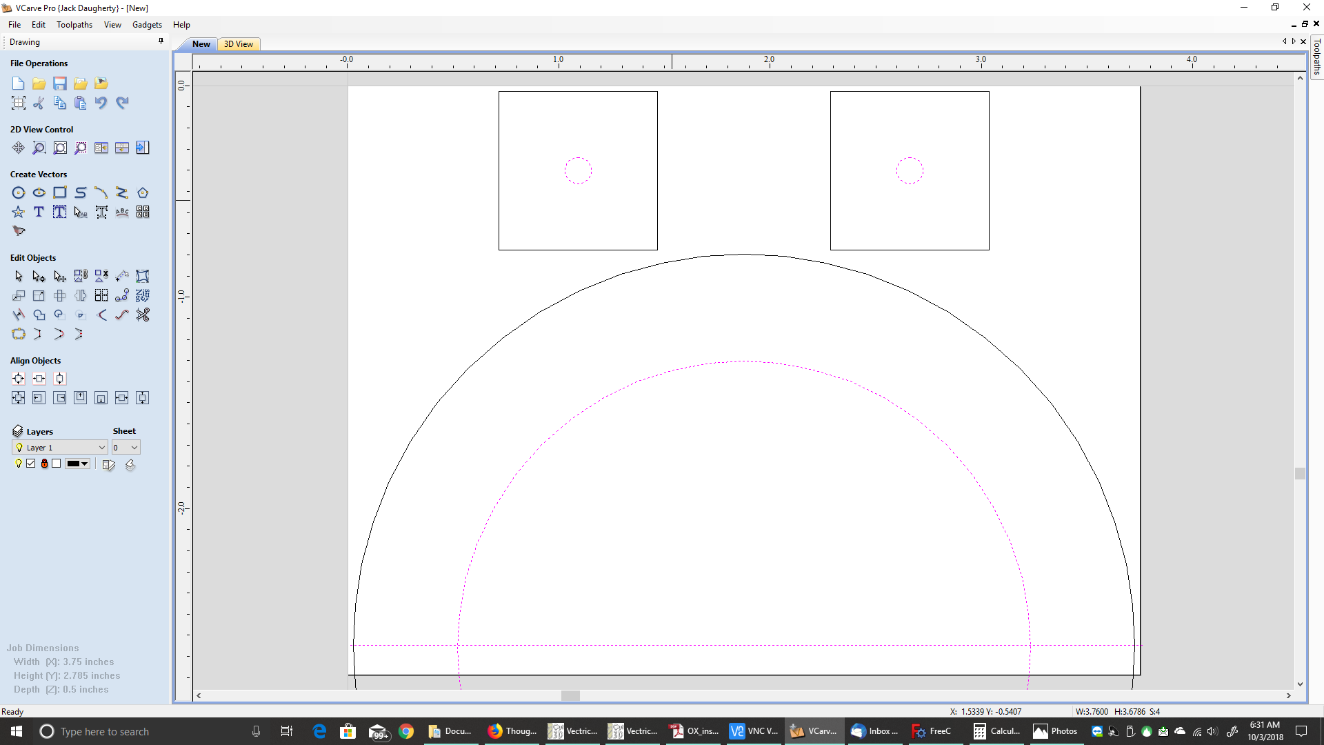

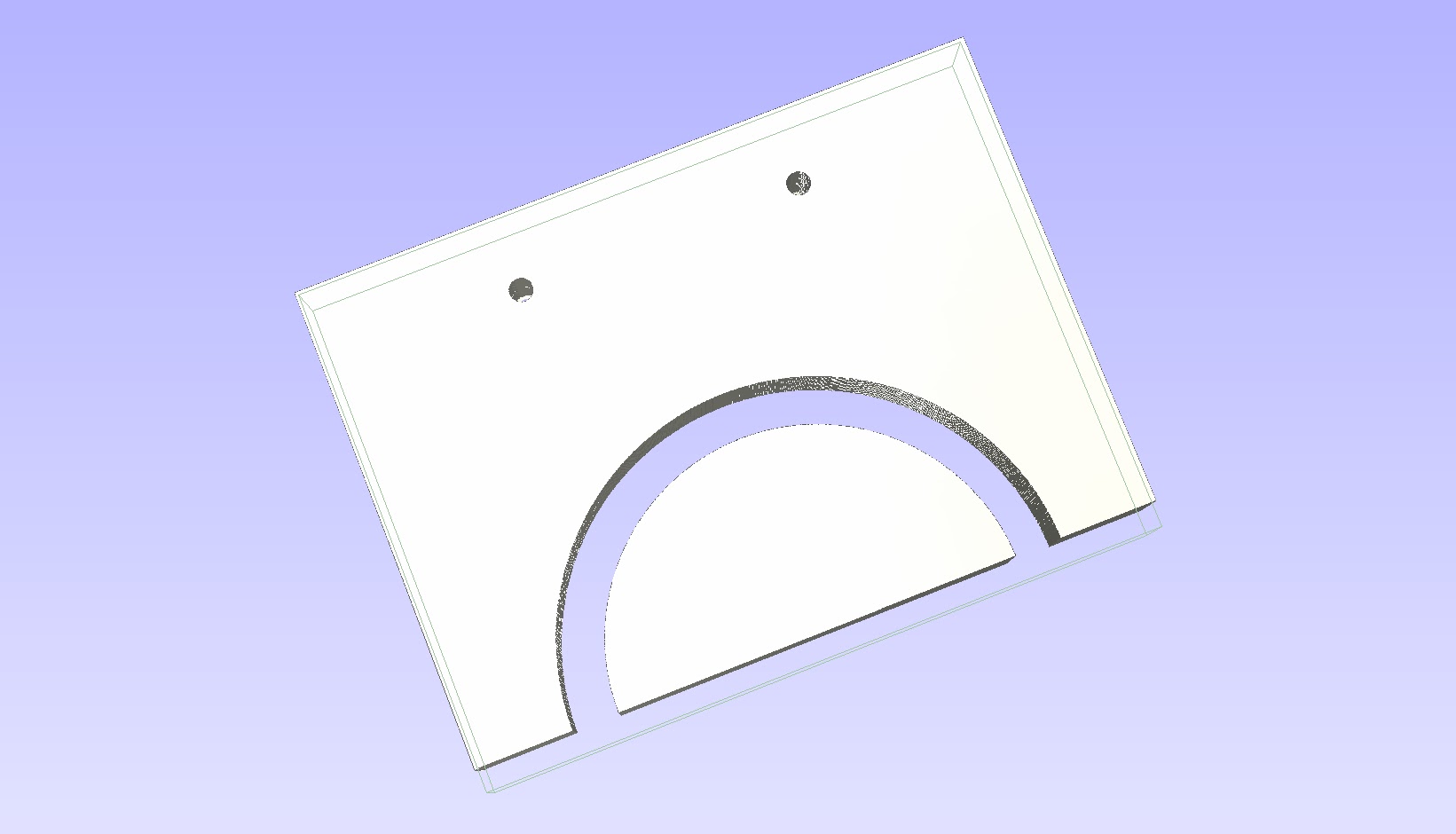

@Hobby_Fab Yeah. I started working on a simple design last night, for the mount. 2 pc. 1/2" thick aluminum plate should do the trick. Hopefully 1.3" from the back of the plate to the closest edge of the mounting hole radius isn’t too much. I wanted to leave enough room for the angle brackets to clear the router body. I’ll make a similar piece for the front cap.
@Mark_Leino I will probably end up with actual collets at some point. I really wasn’t expecting these extra costs so early into it. Gonna do what I can with what I have to use for the time being. That machine looks pretty sweet!
@Jack_Daugherty The squares will be the mounting blocks and the outer circle represents the router body. If I place the mounting blocks on the bottom of the plate instead, I could reduce the distance a little. I don’t know if that would make much difference in over all rigidity.
