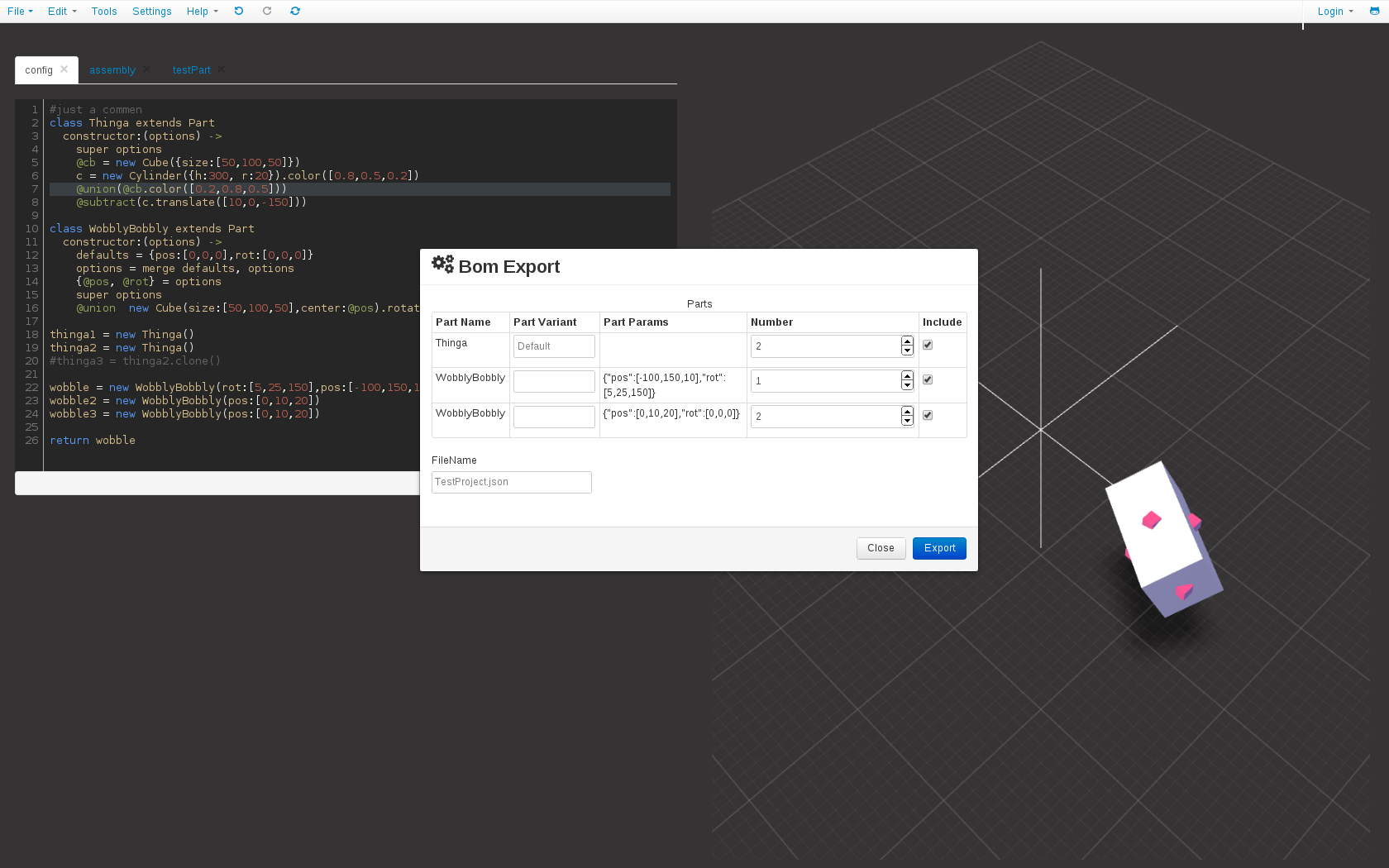

A “small” progress update before I call it a night:
BOM (bill of materials) system is now working : and it’s automagic !
as long as you define new classes as “extending” from the “Part” class (extends Part), all new instances of your classes will be registered
this means that the bom system can count every instance of your user defined parts
you can export the bom as a json file
since we are dealing with parametric designs , each instance of the same class with different parameters is recorded individually!
short example :
Ie : if you have a box with a hole going through, and the parameter is the size of the hole , if you do box1 = new BoxWithHole(holeSize:10) and then box2 = new BoxWithHole(holeSize:50), you will have two entries each with a count of one on the bom list -
Bonus : the red cubes in the picture are a visualization (optional) of all “connectors” of the object: this means you will be able to link objects together at specific points etc (for now this is just a visualization of the connectors as defined by openjscad, but the system will be rewritten later)
