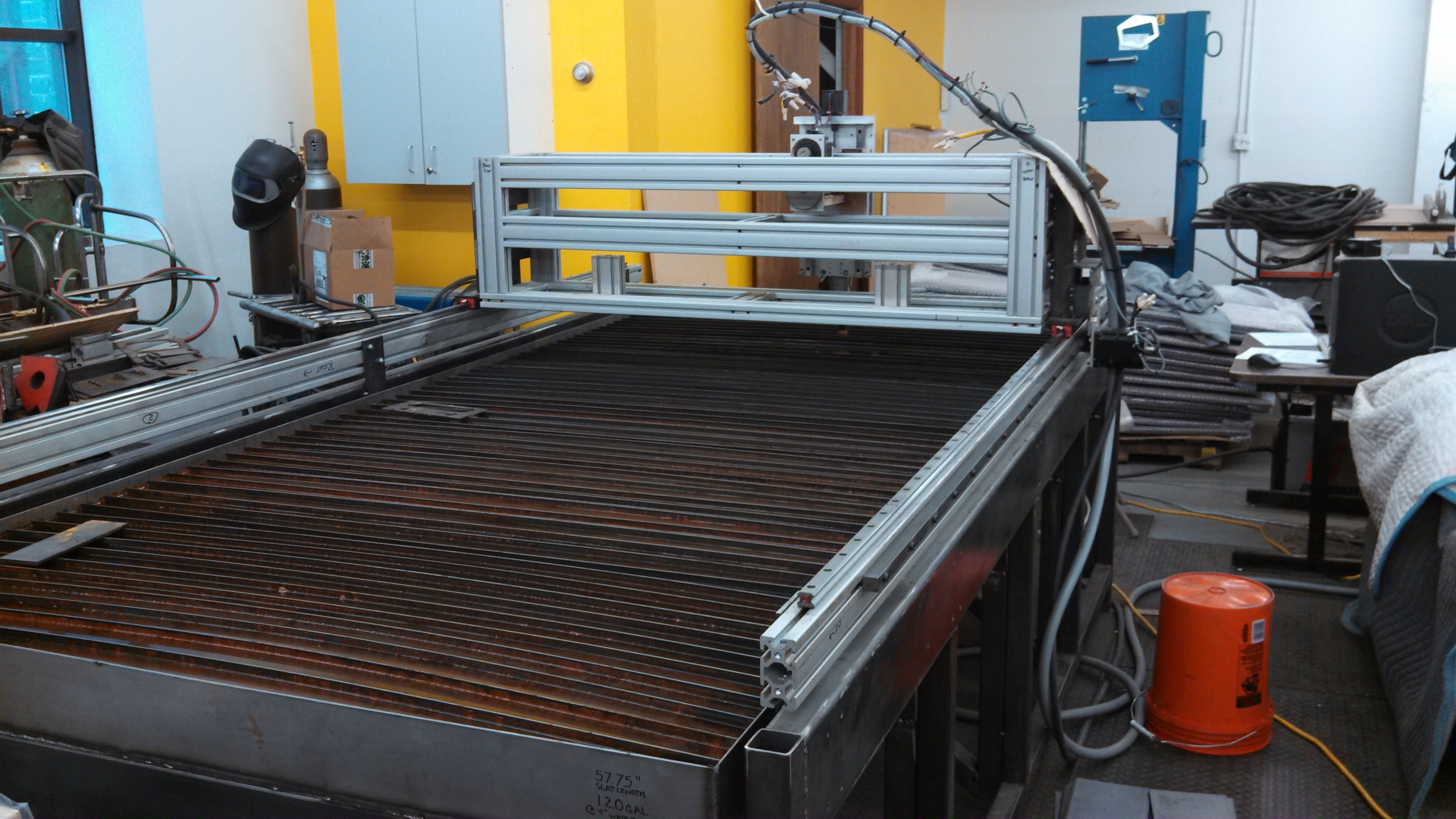

Thought I would share my CNC Plasma build to date. The aluminum extrusions were adapted to this new steel frame from a Machine Tool Camp CNC build that I completed in 2009. It’s still looking rough now, but as I begin cutting I plan to make an improved gantry and new stepper mounts. I’m using gecko drives, a CandCNC mp3000 dthc, mach 3, and a Hypertherm pm85.

Thanks for the comments! This has been a long time coming, I can justify the time spent on the machine build with the future time-savings in cutting complex shapes in steel for clients. Gone are the days of the cardboard pattern and angle grinder with cutting wheel!
