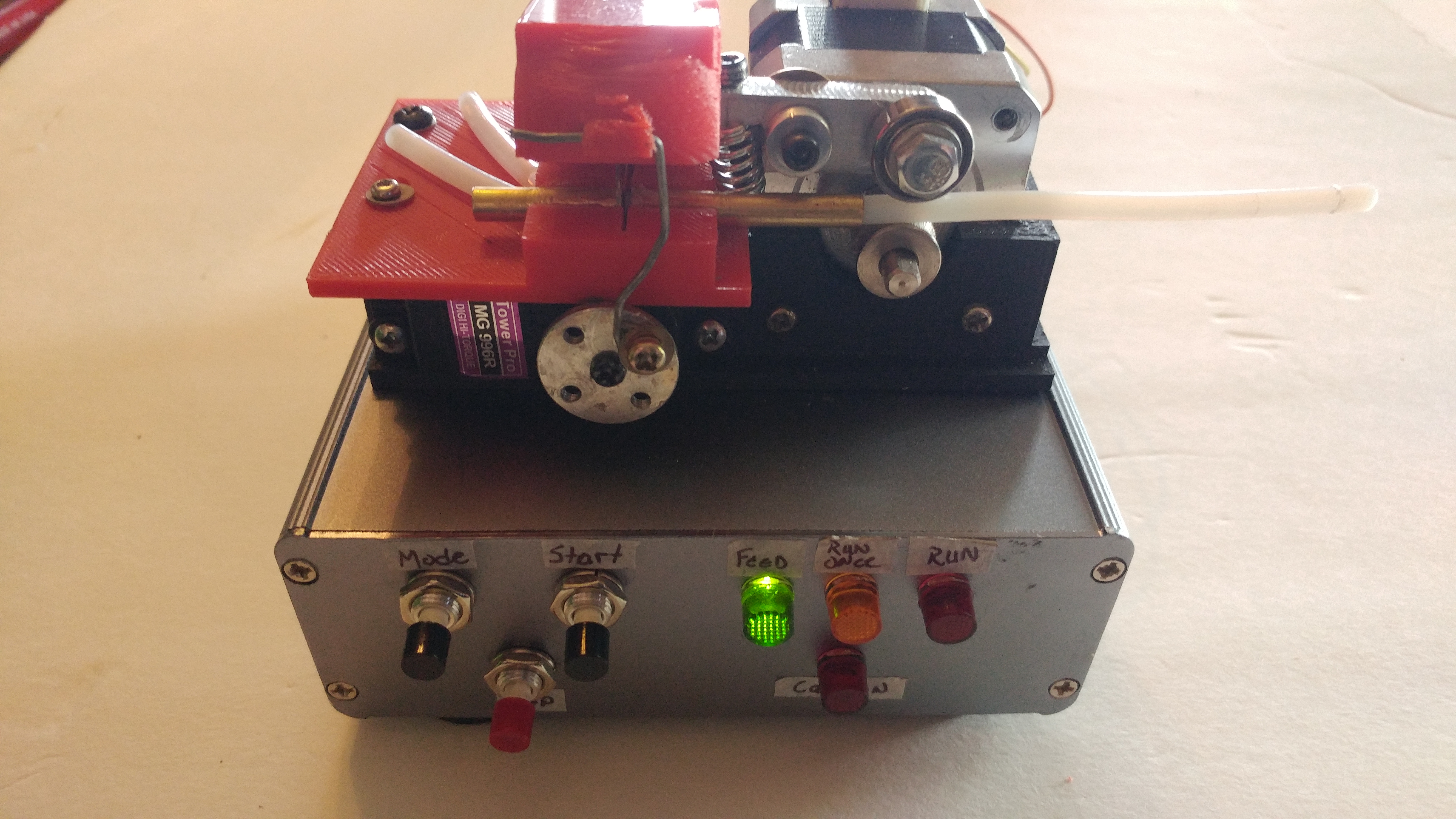

Thought I would share this one. I needed a way to cut ptfe tube to a persice length, so I built a feed and cut machine. Having a 3d printer is the greatest toy I own. One off’ing parts at almost no cost, and little turn around time, is still so amazing even after 4 years.

More photos and details please! Why is the guide on the stepper made out of metal and not 3D printed? What is the brain? How does the cutter hinge? Is that hinge fully 3D printed? How long did it take to design? Make?

I will see about getting a instructable written, time is not my friend these days. The lever for the pressure roller is aluminum because it was actually faster to make then print, and it is stronger. The cutter itself is a modified version of https://www.thingiverse.com/thing:665862. It runs from an Ardunio Nano clone and It took me about a week from design to finished contraption.

I have metal lathe that I sometimes misuse as a mill. The part could be made with a file. I can send you the files and details if you want, email me at 5xtruder@http://gmail.com
