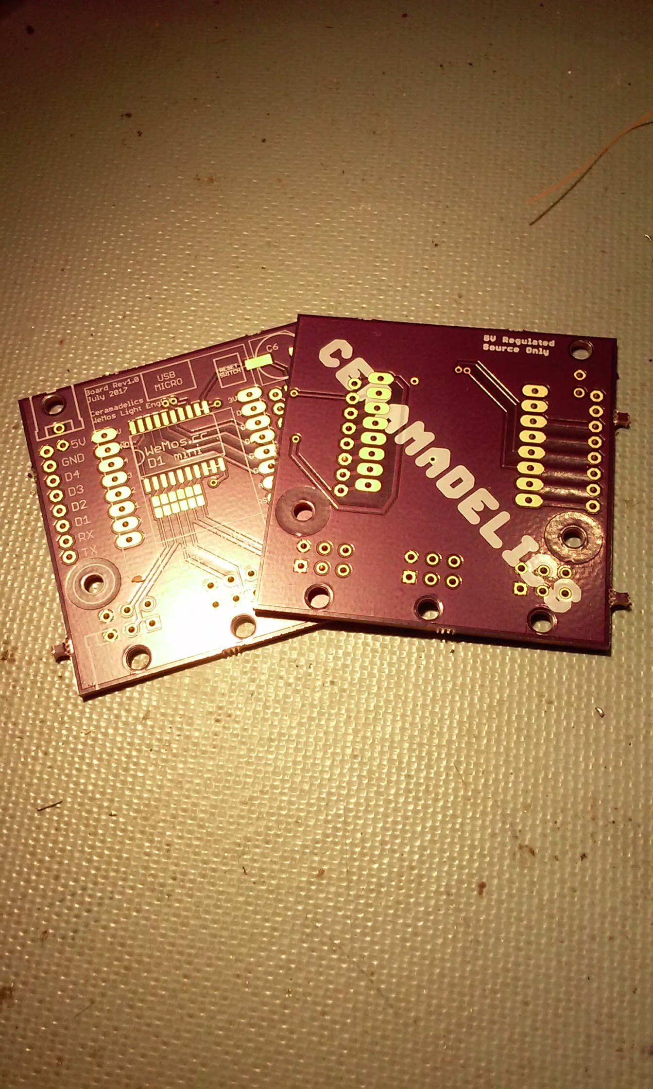

Lately I have been migrating from an older control board to a new one that interfaces WS2812 style LEDs. The new board has 6 channels (only 5 work for now) and uses the ESP8266 WeMOS D1 mini as the micro and the FastLED library! Hopefully at some point I can get this hooked up to ArtNET and possibly make at least one of these wirelessly DMX controllable.
Big thanks to @Jason_Coon of Evil Genius Labs for laying the ground work for this new board. I switched his design to surface mount 74HCT245 and Molex Minifit for output to the strips and a small amount of support circuitry for other functions specific to our light pieces.
For a test of the new hardware I 3D printed an armature and stuffed all this into one of our earlier pieces called the BrainScrambler. We are calling this the BrainScrambler ReScrambled. (The piece is about 16" across and 6" high, 120 LEDs divided into 5 strips, for now its just running a rainbow routine. I am just starting to dip my toe into the FastLed library)

Curious if you are planning to sell these boards? I might be interested.
@Mike_Clifford I thought about it about and might offer them in the future. They would need a respin for sure and I still need to work out the first channel that’s trying to run off of D0 its not working at all. For now you may want to check out @Jason_Coon board from Evil Genius Lab. I leaned on his design heavily for mine and would have gone with it all together except I wanted to add some circuitry specific to our light pieces and also use the Mini Molex plugs which I like :wink:
