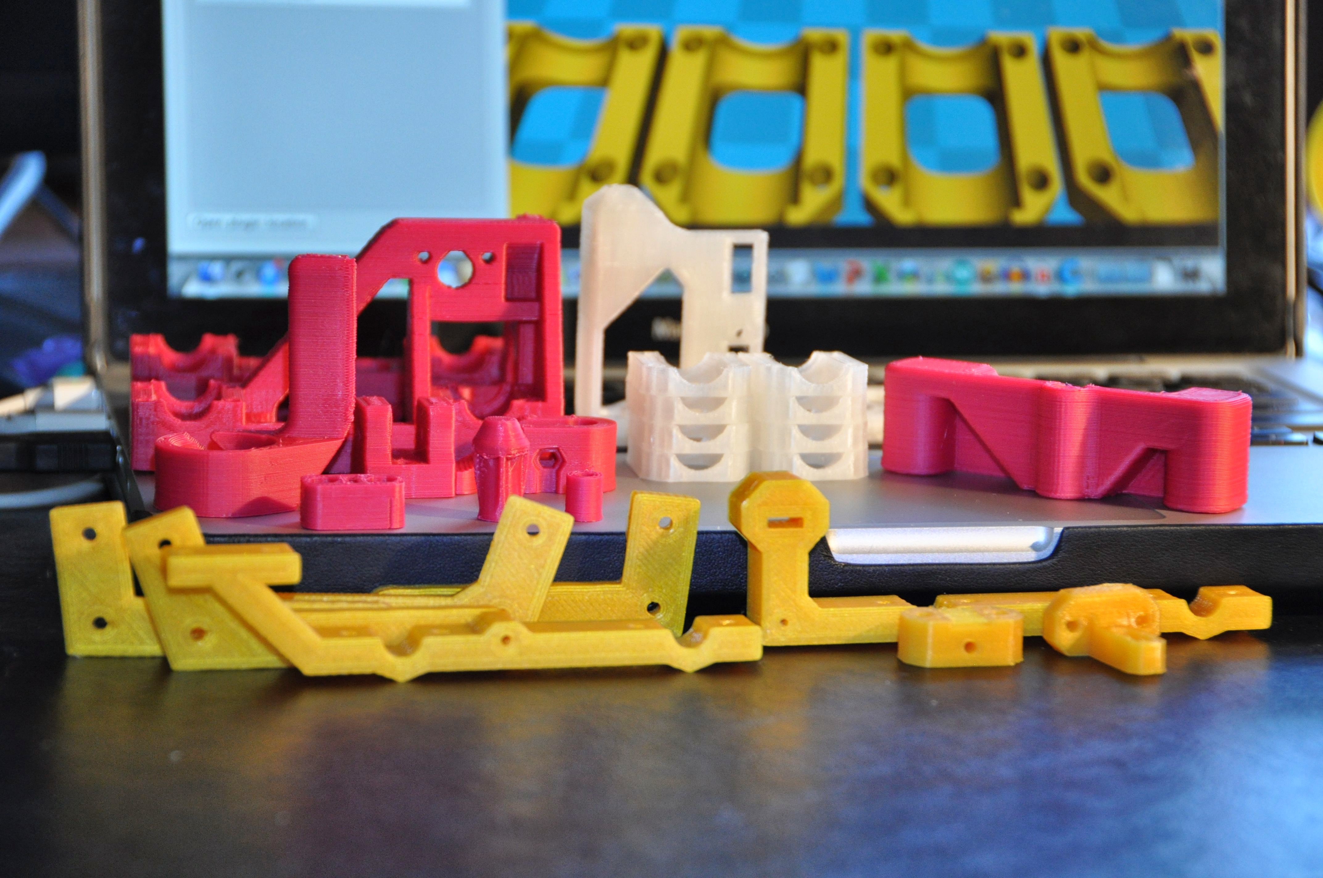

Thought I'd share my freshly printed parts for Carlton Dodd   to modify his
Thought I’d share my freshly printed parts for @Carlton_Dodd to modify his #Printrbot #Simple to use GT2 belts.
The bearing blocks (in clear) were a little challenge in that Slicr didn’t want to print the bridge between the end points. Loaded in Cura to slice and import gcode back into Repetier Host. Nearly everything was printed at .3mm with 20% infill except for large Y-axis mount. It was done at .35 and took 5 hrs to print. Small z stop extension in red near front that looks like a cap was also a challenge. Had to change to .2mm layer height with less infill so it wouldn’t come out as a blob.
Overall I think there’s nearly 20 hours of print time. My printer is set to print very slow. Will mail them out tomorrow Carlton :wink:

@Jonathan These are modification parts for my PrintrBot Simple to extend the X and Y axes. I bought the Simple directly from PrintrBot.
