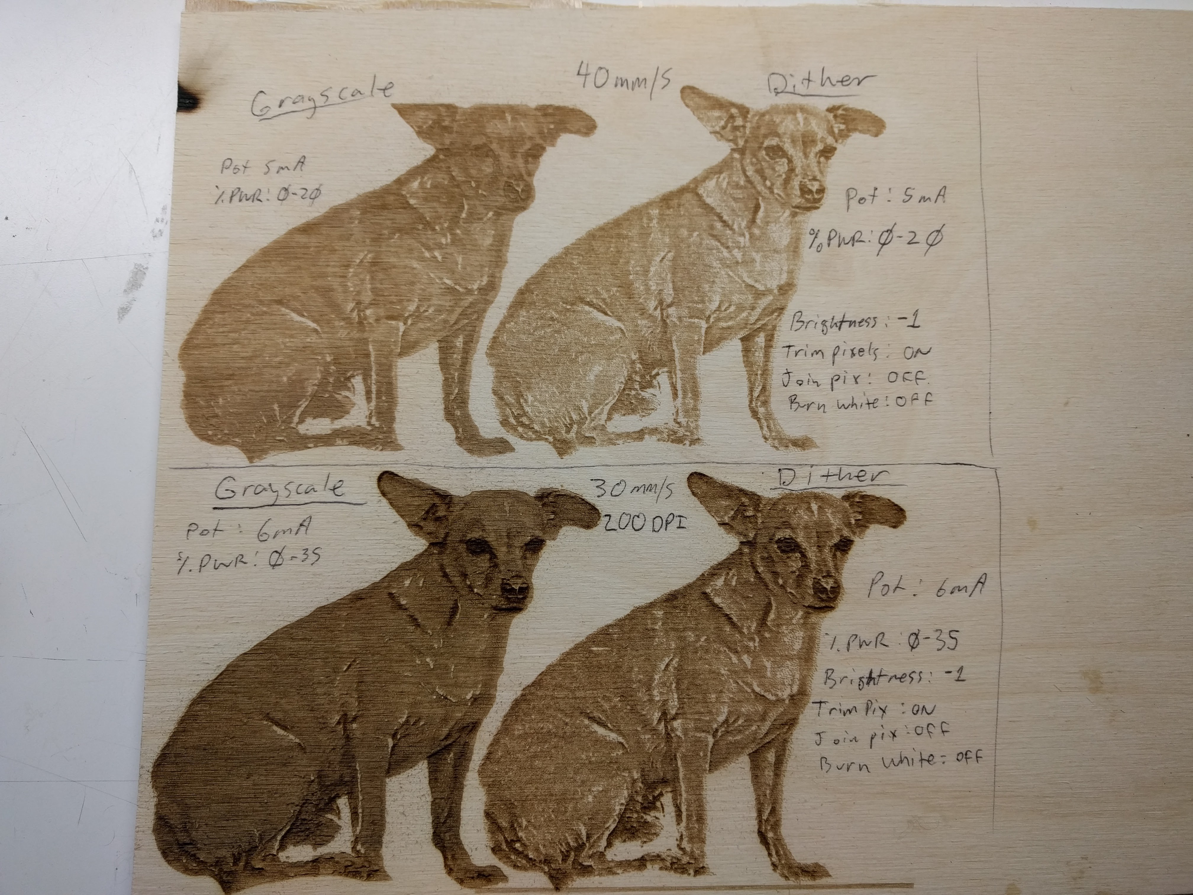

Thought I’d share the solution to what was a frustration as well as a learning curve for me. I have been trying to engrave a dither image for a while now. Every time I created the gcode in LW, it left out almost all of the pixels except for the pixels in groups. Well, I finally tried some of the settings in the raster operation. The one that gave me the best results was the brightness setting. I set it to -1 and LW showed all of my dithered image pixels. At 0, it will only show the large groups of pixels. After I did that, I attempted a couple of comparison engravings that I would like to do on granite, but this is on wood as a test. We recently put our dog to sleep, so we would like to make a granite memorabilia of him. In the photos I did two engravings. each had a grayscale and dither version of the same photo. The two tests differed in the speed/power settings only. I think the top right looks the best. Albeit, this will probably look much different on granite. More tests to follow, but I am glad I figured out how to get all of the dither image pixels included in the gcode!
Top right does indeed look very clear. Although you may find Bottom right works better on the stone due to higher power/lower speed. Keep us updated with the progress

@Arion_McCartney hit that bottom right image with some 400 or 500 grit sandpaper selectively and you will find it’s still a usable engrave. Not much pressure is needed for it
