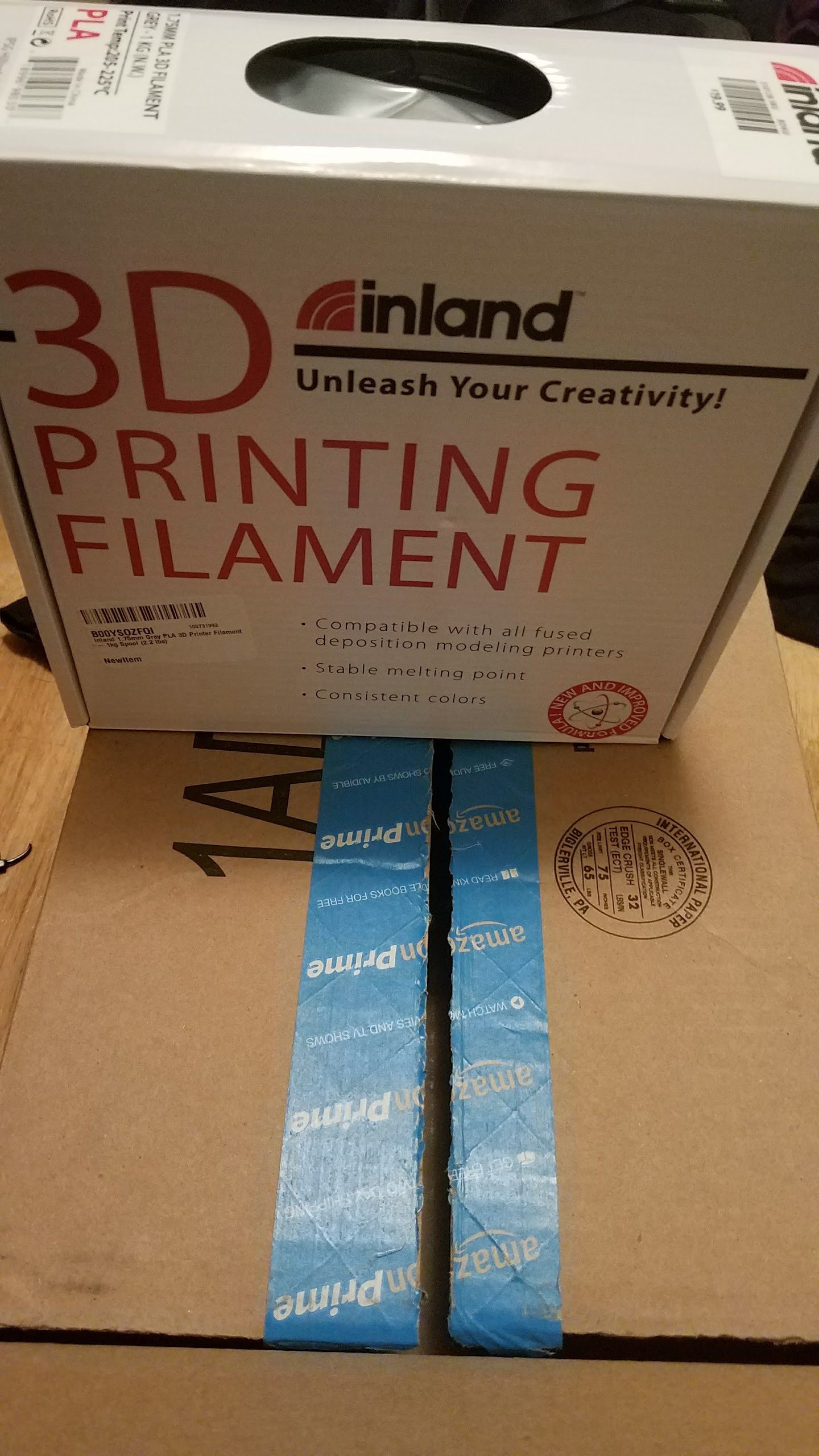

Thought I’d try out a new manufacturer for filament and @ThreeD_Materials ​ has PLA for $23 and a perks program that gives 10% back. I ordered a roll of grey to test them out. I was thoroughly confused when I got a box from Amazon with Inland brand filament, and a return address to Micro Center. Amazon has this on sale for $18 and the filament box has a price printed on it for $20. ThreeD’s website specifically says “our PLA”.
They ended up giving me a full refund, apparently they only ship other manufacturers’ filament if their out of stock of theirs.
