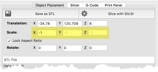

Thought this was too good to not share. Been printing some parts for a drone and realized that the provided arms needed to be mirrored. Started to open up meshmixer but found that you can easily mirror parts in Repetier Host by entering ‘-1’ within the scale box.
Doesn’t get any easier than that…
There’s a mirror button in the windows version. Not seeing it in your screenshot.
Unfortunately I’m using the Mac version so it’s like rev .5x. Been thinking of getting Simplify 3D cause I know I’m missing out on convenience features.
