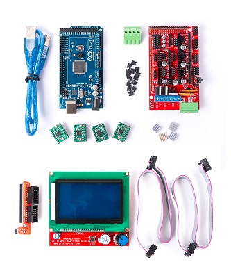

Thoughts on the RAMPS arduino kits? I just ordered one,
Thoughts on the RAMPS arduino kits? I just ordered one, couldn’t resist at only $40. I was curious as how they compare to smoothie boards. The install seems fairly easy, I ordered the middleman board and will have some extras I’ll give away to the group.
