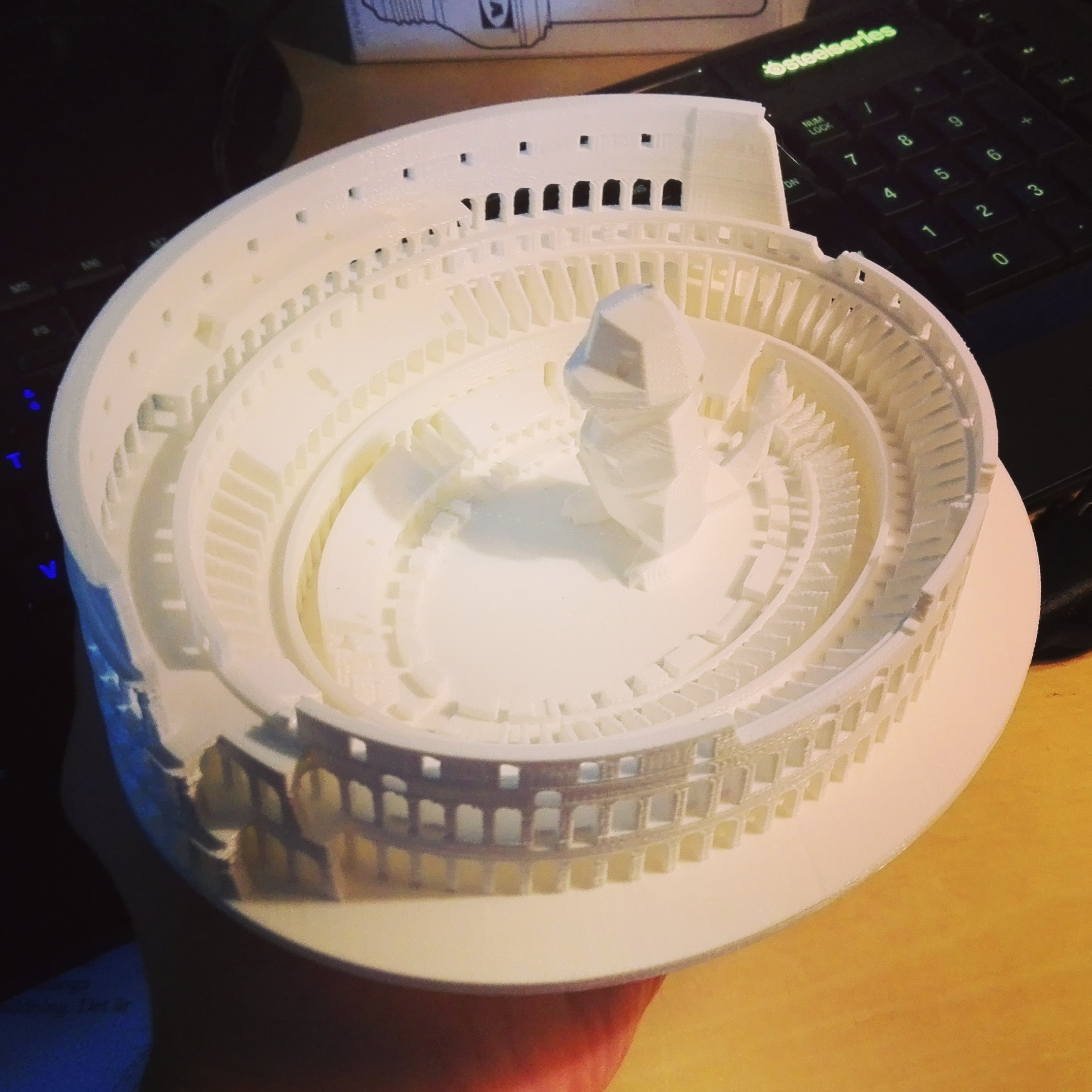

Thoughts? PLA 220C bed 45c 60mm/s 2mm retraction at 45mm/s travelspeed 90mm/s scaled up 20%. Made on an i3… Cura and sd… i will try to do a bigger 3dbenchy with this later today…
Charmander?
@Kaitlyn_Hess yes
