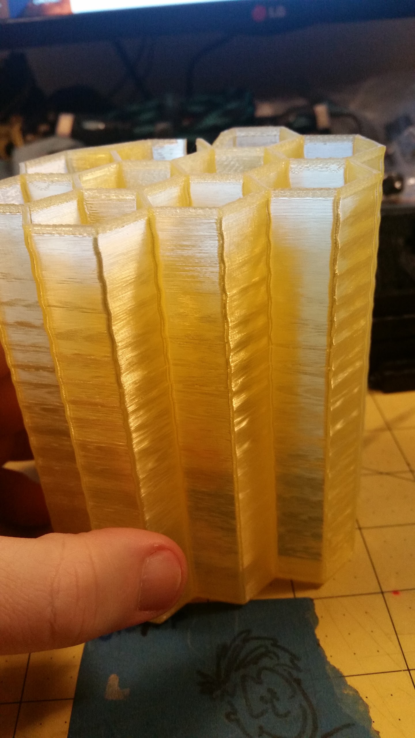

http://www.dbclunie.com - So I have a couple of prints that I was doing I derived from http://www.thingiverse.com/thing:961176 . I printed the initial hive file (or a remix actually that just added windows to the back to snake your cable through) and with the initial print I kept getting this terrible banding along the z-axis which I thought might be z-wobble but it seems a bit too “wide” to be so, so I’m not sure exactly what this is or how to fix it or what causes it.
1st & 2nd images
If you run your finger along the walls you can feel the bumps so its not just within the print. could this be a result of some kind of weird infill (which i think i had set to 20% but as you can tell the walls are thin enough where it doesn’t do any infil.

The only thing that I can think of, is that a single layer of the boat is going to be much larger than a single layer of the hex tubing. Uneven cooling due to constant new material on top leading to a “lumpy” strata effect maybe? Anyway, all I can think of off the cuff. If so, try putting an active cooler blowing just over your print bed.
I get banding similar to what you have pictured here when I crank the print speed up too much. it is usually more pronounced on large straight areas with sharp corners.
This happened to me when i had my steppers configured with a stepsize 157.5 someone told me that the firmware makes rounding errors so layers aren’t consistent. Try a slightly different step size and see if it changes.
not sure that is easy to do on the trinus
i just did a single pillar and no steps. hmmm i did check smart infill will investigate further and update blog… :slight_smile:
