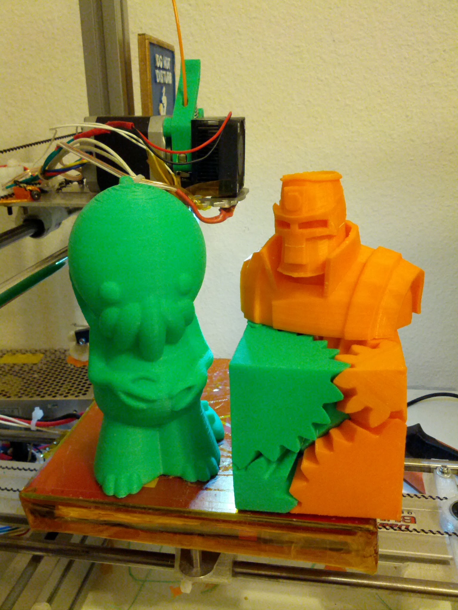

Three of my prints from this week! The bust of the Team Fortress 2 Demoman’s helmet was designed by my friend @Julian_Grijalva . I increased my in-fill and increased top layers to 5 to avoid the holes I got in the almost hollow Cthulhu. And, of course, the classic cube gear for my sister.
thx for the Top Layer Tip
It was a guess so make sure to check there’s enough in-fill to successful make top shells
