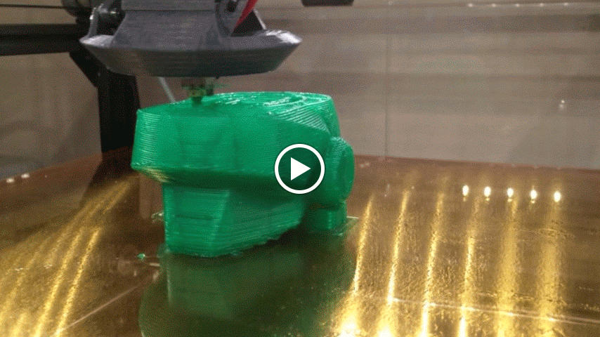

Throwing some PLA down with the volcano: 1.2mm nozzle, .7mm layer height, 1.2mm shell, 1.4mm bottom/top, 15% infill, 28mm/s speed, 240C hotend, 70C bed. Model dimensions: 82mm x 103mm x 71mm. Total time: 75 minutes.
Clearly it’s fast. But around 1:00 or so, it seems to be pausing a lot.
Yeah, I disabled combing on the skin in Cura, so it ended up with a lot of retraction.
