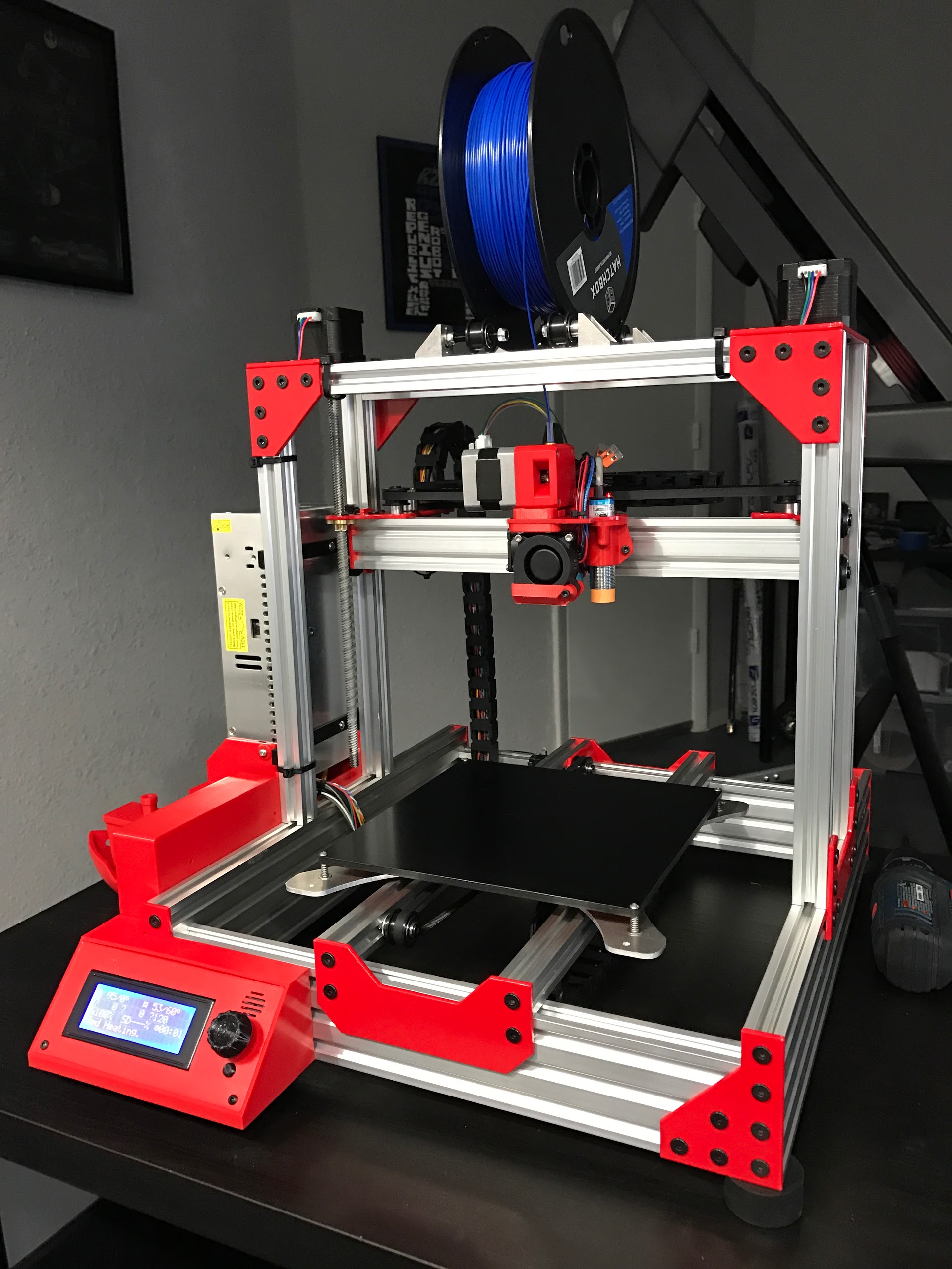

Thx @Alex_Lee for a great design, after sitting on my self for over a year it’s finally built. Now to get this guy tuned. Btw do you or @Eclsnowman have a Simplify3D profile I could use as a base.
@Amit_Patel she looks amazing! can’t wait to see her printing. Thank you for sharing!
@Alex_Lee what micro stepping are u using for your bondtech mini, im getting allot of slipping and have check allignment of the gears and they look to be aligned but still having slips on the exstruder
@Amit_Patel I believe I have my microstepping set to 475 steps/mm. I haven’t had problems with slipping, does it extrude at all? Maybe bumping up the temperature a little may also help.
I’m really curious to get a close up of how you did the cable routing? I’ve been scratching my head now for a while on that one!
@Michael_Johnson I did grind off most of it but maybe not enough. Will give that a shot and see if the gears work any better. Thx for the suggestion.
