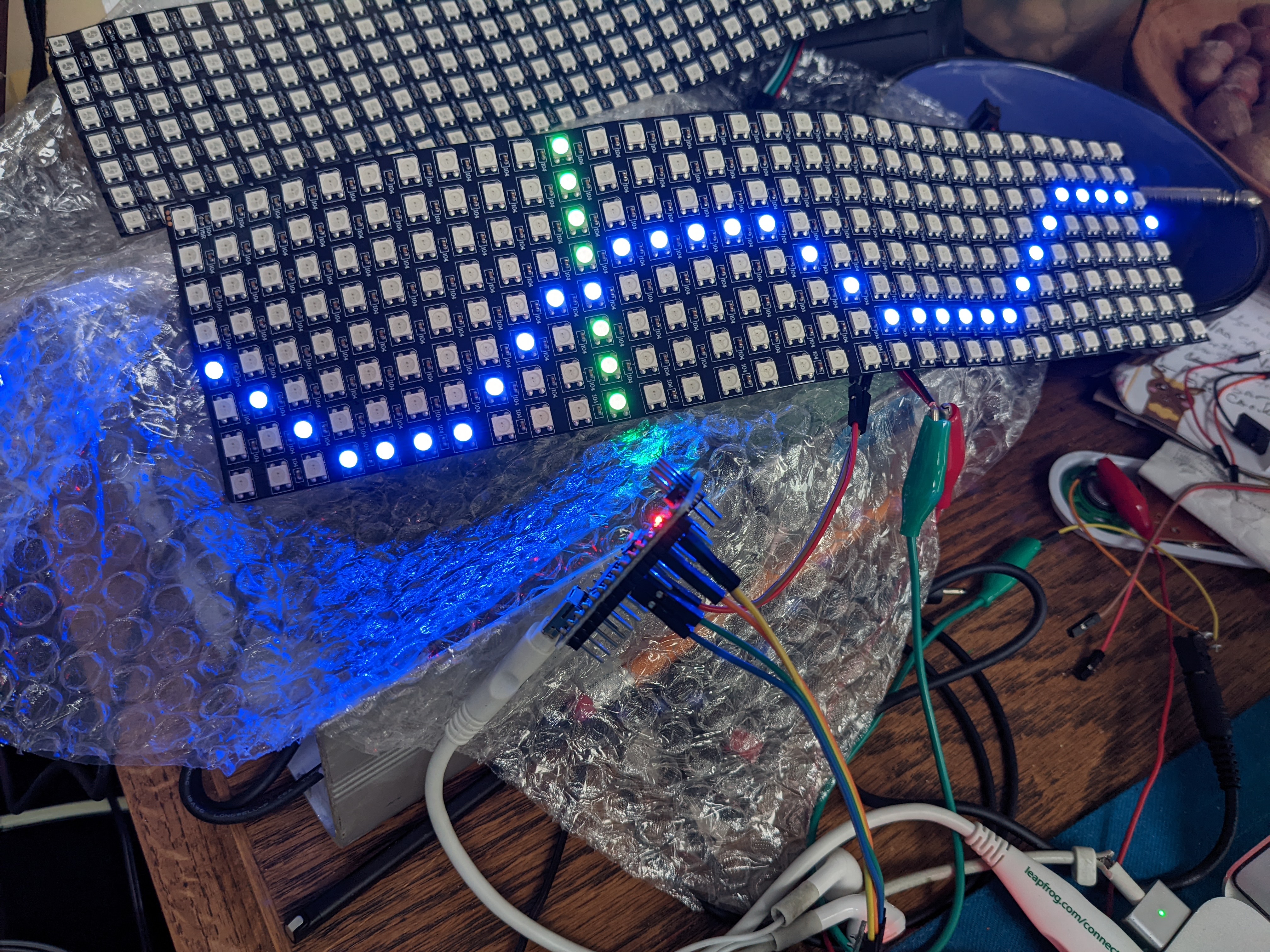

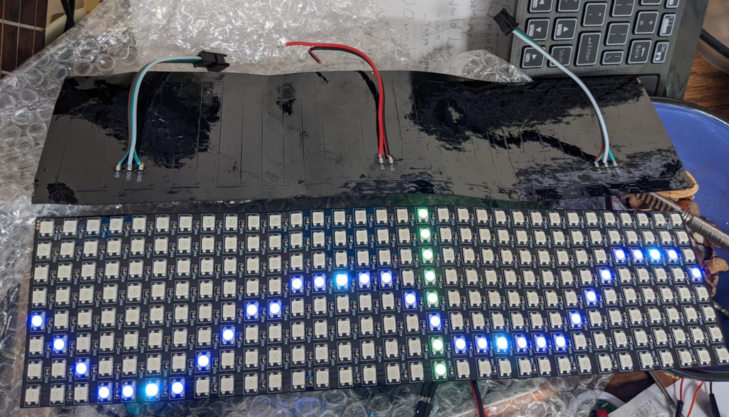

Here’s the first working version of the Tide Chart LED Matrix project using a single 32x8 WS2812b matrix.
video - tide chart using ws2812b matrix - YouTube
I round the floating point tide heights into an int8_t(byte) array.
2022/3/20
Todays tide in 45 minute increments:

// Other sites available at http://github.com/millerlp/Tide_calculator
// using a 32x8 segment matrix display for the tide chart graph
const int8_t iChartCol=32;
int8_t iChartData[32];
float fChartData[32];
int8_t iChartDataDec[32];
RTC_DS3231 rtc;
#define BRIGHTNESS 25 // Set BRIGHTNESS to about 1/5 (max = 255)
#define MATRIX_WIDTH  8
#define MATRIX_LENGTH 32
#define LED_COUNT 32*8
// Declare our NeoPixel strip object:
Adafruit_NeoPixel strip(LED_COUNT, PIN, NEO_GRB + NEO_KHZ800);
// Argument 1 = Number of pixels in NeoPixel strip
// Argument 2 = Arduino pin number (most are valid)
// Argument 3 = Pixel type flags, add together as needed:
//   NEO_KHZ800  800 KHz bitstream (most NeoPixel products w/WS2812 LEDs)
//   NEO_KHZ400  400 KHz (classic 'v1' (not v2) FLORA pixels, WS2811 drivers)
//   NEO_GRB     Pixels are wired for GRB bitstream (most NeoPixel products)
//   NEO_RGB     Pixels are wired for RGB bitstream (v1 FLORA pixels, not v2)
//   NEO_RGBW    Pixels are wired for RGBW bitstream (NeoPixel RGBW products)
void setup() {
  if (! rtc.begin()) {
    Serial.println("Couldn't find RTC");
    Serial.flush();
    while (1) delay(10);
  if (rtc.lostPower()) {
    Serial.println("RTC lost power, let's set the time!");
    // When time needs to be set on a new device, or after a power loss, the
    // following line sets the RTC to the date & time this sketch was compiled
    rtc.adjust(DateTime(F(__DATE__), F(__TIME__)));
    // This line sets the RTC with an explicit date & time, for example to set
    // January 21, 2014 at 3am you would call:
    // rtc.adjust(DateTime(2014, 1, 21, 3, 0, 0));
  // When time needs to be re-set on a previously configured device, the
  // rtc.adjust(DateTime(F(__DATE__), F(__TIME__)));
  strip.begin();           // INITIALIZE NeoPixel strip object (REQUIRED)
  strip.show();            // Turn OFF all pixels ASAP
  strip.setBrightness(BRIGHTNESS);
  // initialize fChartData[]
  for( int8_t i=0; i<iChartCol; i++ ){
     iChartData[i]=0;
     fChartData[i]=0;
     iChartDataDec[i]=0;
  // For debugging output to serial monitor
  Serial.begin(57600); // Set baud rate to 57600 in serial monitor for slow 8MHz micros
  getChartData();//iChartData, iChartCol);
  Serial.println(F("Todays tide in 45 minute increments:"));
  for( int8_t x=1; x <= iChartCol; x++ ) {
    Serial.print(F(" Tide height: "));
    //Serial.print(iChartData[x-1],3);
    Serial.print(fChartData[x-1],3);
    //Serial.print(".");Serial.print(iChartDataDec[x-1]);
    Serial.print(F(" ft."));
    Serial.println();
  Serial.println();
void loop() {
  // check for new day and run getChartData() on newday( hour=0 )
  static int8_t iLastHour = 24;
  if( rtc.now().hour() == 0 && iLastHour != 0){ // new day
    getChartData();
    iLastHour=0;
    strip.clear();
  else
    iLastHour = rtc.now().hour();
  const int8_t iSpeed = 10; //lower is faster
  // Fill along the length of the strip in various colors...
  //colorWipe(strip.Color(255,   0,   0)     , iSpeed); // Red
  timeLine(strip.Color(  0,   50, 0)     , iSpeed/5); // light Green
  tideWipe(strip.Color(  0,   0, 255)     , iSpeed); // Blue
// Fill strip pixels one after another with a color. Strip is NOT cleared
// first; anything there will be covered pixel by pixel. Pass in color
// (as a single 'packed' 32-bit value, which you can get by calling
// strip.Color(red, green, blue) as shown in the loop() function above),
// and a delay time (in milliseconds) between pixels.
void colorWipe(uint32_t color, int wait) {
  for(int i=0; i<strip.numPixels(); i++) { // For each pixel in strip...
    strip.setPixelColor(i, color);         //  Set pixel's color (in RAM)
    strip.show();                          //  Update strip to match
    delay(wait);                           //  Pause for a moment
// Turn on a matrix columns pixel one after another with a color.
// Color(red, green, blue) as shown in the loop() function above),
void tideWipe(uint32_t color, int wait) {
  int8_t iCol;
    // check for which column
    iCol = i/MATRIX_WIDTH;
    //Serial.print("column:");Serial.println(iCol);
    if( (iCol % 2) == 0 ) // true == even
        strip.setPixelColor(7+(iCol*MATRIX_WIDTH)-iChartData[iCol], color);         //  Set pixel's color (in RAM)
    else // odd
        strip.setPixelColor((iCol*MATRIX_WIDTH)+iChartData[iCol], color);         //  Set pixel's color (in RAM)
void timeLine(uint32_t color, int wait) {
  int8_t iCol, iTimeCol;
  int8_t iHour, iMinutes;
  static int8_t iCurCol=0;
  DateTime curTime;
  curTime = rtc.now();
  iHour = curTime.hour();
  iMinutes = curTime.minute();
  iTimeCol=abs((iHour*60+iMinutes)/45);
    if( iCol == iTimeCol ) { // true == even
      if( iCol != iCurCol ) // clear previous line
        for(int8_t j=0; j<MATRIX_WIDTH; j++)
          strip.setPixelColor(iCurCol*MATRIX_WIDTH+j, strip.Color(0, 0, 0)); // Clear pixel's
        strip.setPixelColor(iCol*MATRIX_WIDTH+j, color);      //  Set pixel's color (in RAM)
      iCurCol=iCol;
void getChartData(void) {
  TideCalc myTideCalc; // Create TideCalc object called myTideCalc
  float result;
  DateTime today, startTime;
  //today = DateTime(__DATE__,__TIME__);
  //today = DateTime(2022,3,19,13,29,0);
  today = rtc.now();
  Serial.print(today.year(), DEC);
  Serial.print('/');
  Serial.print(today.month(), DEC);
  Serial.print('/');
  Serial.println(today.day(), DEC);
  startTime = DateTime(today.year(),today.month(),today.day(),00,00,0); // TODO: get today() hr=0 min=0
  // 24 hours in a day but 32 segments...
  //(24hr * 60min * 60sec)/32 // seconds/day / 32
    result = myTideCalc.currentTide(startTime.unixtime() + ((24 * 60L * 60)/iChartCol) * x);
    fChartData[x-1] = result;
    iChartData[x-1] = (int8_t)round(result);
    int whole = (int)result;
    //Serial.print(result,3);Serial.print("::");Serial.println((int8_t)abs((result-whole)*100));
    iChartDataDec[x-1] = (int8_t)abs((result-whole)*100);
Close to final! Here is what is working:
Able to calculate 10 years of tide predictions
RTC(realtime clock) generates accurate date/time
Daily tide prediction updates occur at midnight
Cursor indicates current time( green line )
Tide graph data tests for out of bounds(greater than 7ft and less than 0 ft) situations
Annotated tide peaks( needs more edge case testing )
Annotate King Tide peaks
What’s not working:
nothing noticed so far but expect min-max peak detection to show something when peaks happen at columns 0 or 31.
TODO:
Adjust tide calc graph to remove daylight savings adjustment. Clock cursor should be on 24hr lines
Enable/disable serial output with a DEBUG flag
Add 2 buttons to move the cursor forwards or backwards in time(ie 24hr clock time adjustment).
wood cover: laser cut a piece of wood so LEDs show through holes
wood cover: laser engrave time marks and other decorations
Make a box for holding electronics and add micro-USB connector for powering
source code:
#include <Adafruit_NeoPixel.h>
//Header files for talking to real time clock
#include <Wire.h> // Required for RTClib
#include <SPI.h> // Required for RTClib to compile properly
#include <RTClib.h> // From https://github.com/millerlp/RTClib
#define PIN 6
// Tide calculation library setup.
#include "TidelibLaJollaScrippsInstitutionWharfCalifornia.h"
int8_t iMinMax[4];
RTC_DS3231 rtc;
#define BRIGHTNESS 40 // Set BRIGHTNESS to about 1/5 (max = 255)
void setup() {
    Serial.flush();
     iChartData[i]=0;
     fChartData[i]=0;
     iChartDataDec[i]=0;
  getMinMaxData();
    Serial.println();
  Serial.println();
void loop() {
    getChartData();
    getMinMaxData();
    iLastHour=0;
    strip.clear();
  else
  tideWipe(strip.Color(  0,   0, 75)     , iSpeed); // Blue
  //minMaxPeaks(strip.Color(  0,   0, 255)     , iSpeed/5); // Blue
  for(uint16_t i=0; i<strip.numPixels(); i++) { // For each pixel in strip...
  int8_t iCol;
  uint32_t iColor = color;
    // set tide peaks colors
    if( iCol==iMinMax[0] || iCol==iMinMax[1] || iCol==iMinMax[2] || iCol==iMinMax[3] )
       if( fChartData[iCol]>=7 || fChartData[iCol]<=-1.0 )
          color=strip.Color(75,0,0); // red marks King Tide
       else
          color=strip.Color(48,213,200); // turquoise
      //color=strip.Color(48,213,200); // turquoise
    else
      color=iColor;
    else // odd
  DateTime curTime;
      for(int8_t j=0; j<MATRIX_WIDTH; j++){
        // test if pixel color is already set, skip if isSet
        if( strip.getPixelColor(iCol*MATRIX_WIDTH+j) == 0 )
      iCurCol=iCol;
void minMaxPeaks(uint32_t color, int wait) {
  int8_t iCol;
  uint32_t iColor, iBrightColor;
  iBrightColor=strip.Color(255,127,127);
    if( iCol==iMinMax[0] || iCol==iMinMax[1] || iCol==iMinMax[2] || iCol==iMinMax[3] ){
      color = iBrightColor;
      else // odd
      else
        color = iColor;
  float result;
  today = rtc.now();
  Serial.print('/');
  Serial.print('/');
    // test if low tide is less than 0 and move to zero. Disp only does 0-7'
    if( result < 0.50 )
      iChartData[x-1] = 0;
void getMinMaxData(void) {
  int8_t iFMin, iFMax, iSMin, iSMax;
  iMinMax[0]=iFMin = findMin(0);
  iMinMax[1]=iFMax = findMax(0);
  if( iFMax < iFMin ) {
    //iFMax = findMax(iFMin);
    iMinMax[1]= iFMax = findMax(iFMin);
  // find 2nd Min and Max
  iMinMax[2]=iSMin = findMin(iFMax);
  iMinMax[3]=iSMax = findMax(iSMin);
  if( iSMax < iSMin ) { // 2nd max returned 0
    //iSMax = findMax(iFMin);
    iMinMax[3]=iSMax = findMax(0);
  Serial.print("First Min=");Serial.println(iFMin);
  Serial.print("First Max=");Serial.println(iFMax);
  Serial.print("Second Min=");Serial.println(iSMin);
  Serial.print("Second Max=");Serial.println(iSMax);
int8_t findMin(int iStart)
  for( int i=iStart; i<32; i++ )
    if( (i<31) && (fChartData[i]-fChartData[i+1] < 0))
      return i;
  return 0;
int8_t findMax(int iStart)
    if( (i<31) && (fChartData[i+1]-fChartData[i] < 0))
      return i;
  return 0;
Tide peak detection is a PIA when using just a 24hr window of data. There are a bunch of edge cases to deal with as the tide graph changes and shifts from day to day.
The findMin() and findMax() functions are easy but for the changing tides, treating each day as its own dataset doesn’t seem to be the right technique.
For example yesterday there were only 3 peaks and then today where the first Max peak happens on the 2nd data point while the first Min peak ended up on the first data point since it was rising.
I can’t use a circular buffer since the tide graph is really continuous so the end of the day has nothing to do with the beginning of the day.
Currently, I’m looking for first Min peak and first Max peak and working the edge cases from there. I even added one extra data point at the end of the day to help with one edge case.
Data:
First Min=11
First Max=1
Second Min=24
Second Max=20
 Tide height: 5.040 ft.
 Tide height: 5.060 ft.
 Tide height: 4.844 ft.
 Tide height: 4.408 ft.
 Tide height: 3.794 ft.
 Tide height: 3.064 ft.
 Tide height: 2.292 ft.
 Tide height: 1.557 ft.
 Tide height: 0.928 ft.
 Tide height: 0.463 ft.
 Tide height: 0.195 ft.
 Tide height: 0.136 ft.
 Tide height: 0.269 ft.
 Tide height: 0.558 ft.
 Tide height: 0.950 ft.
 Tide height: 1.385 ft.
 Tide height: 1.800 ft.
 Tide height: 2.147 ft.
 Tide height: 2.390 ft.
 Tide height: 2.515 ft.
 Tide height: 2.529 ft.
 Tide height: 2.458 ft.
 Tide height: 2.341 ft.
 Tide height: 2.227 ft.
 Tide height: 2.161 ft.
 Tide height: 2.182 ft.
 Tide height: 2.313 ft.
 Tide height: 2.560 ft.
 Tide height: 2.911 ft.
 Tide height: 3.334 ft.
 Tide height: 3.785 ft.
 Tide height: 4.213 ft.
 Extra: 4.56
Source code:
Note: findMin() and findMax() take the index in the array to start searching.
  bool bStart = false; //true=hightide, false=lowtide
  iFMin = findMin(0);
  iFMax = findMax(0);
  if( iFMin > 8 || (iFMax-iFMin<5) ) {  // there should be a max BEFORE the first min
      bStart = true;
      iFMax = findMax(0);
      iFMin = findMin(iFMax);
  else {
      bStart = false;
      iFMin = findMin(0);
  /*if( iFMax < iFMin ) {
  if( bStart ) { // 1max, 1min, 2max, 2min
      iSMin = findMin(iSMax);
  else { // 1min, 1max, 2min, 2max
  // deal with edge cases like the high or low tide ending on the 32 element
  if( !bStart && (iSMax < iSMin) && (iFMin==8)) { // 2nd max returned 0
    iSMax = 31; // set to last hour
  // populate the MinMax[] list
      iMinMax[0]=iFMax;
      iMinMax[1]=iFMin;
      iMinMax[2]=iSMax;
      iMinMax[3]=iSMin;
      iMinMax[0]=iFMin;
      iMinMax[1]=iFMax;
      iMinMax[2]=iSMin;
      iMinMax[3]=iSMax;
I have an idea… I will have the previous peaks in the iMinMax[4] array when the next call to findPeaks() is made so I could analyze it to find out if the last peak was a Max or Min and then I’d know the sequence(min/max/min/max or max/min/max/min) to start with for the next/new day. Maybe even use the previous array location in time to test to make sure the first new peak’s starting time makes sense.
On bootup, when iMinMax is all zeros I could try modify the current getMinMaxData() function to get the previous day’s data and generate the previous peaks data then use the updated getMinMaxData() using the previous peaks information…
