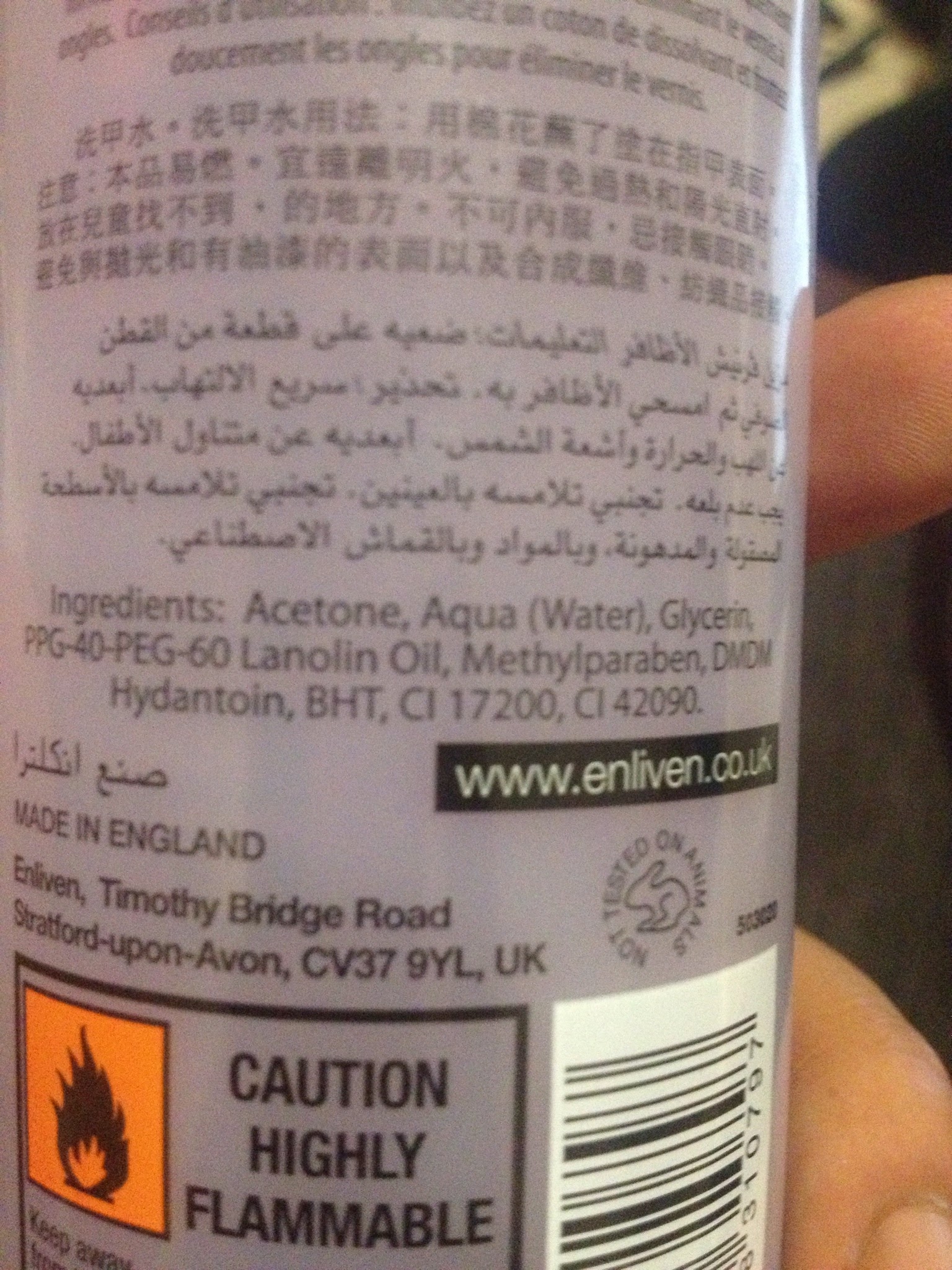

TIL: this nail polish remover sucks from cleaning the glass on my heat bed
Get the stuff in the rectangular blue/yellow metal tin. It’s usually found in the paint isle of most superstores.
This one contains oil :frowning:
I got some pure aceton from the drug store, no other ingredients.
Yh, it was until I got home I realised it had oil in it. Should of know better really. I’ve ordered some acetone from eBay so that should be here soon :slight_smile:
Glycerin, oil, wax… Yeah, that’s gonna be a bad time.
Yeah, it messed up the glass for a few prints. Seems to be cool now :slight_smile:
