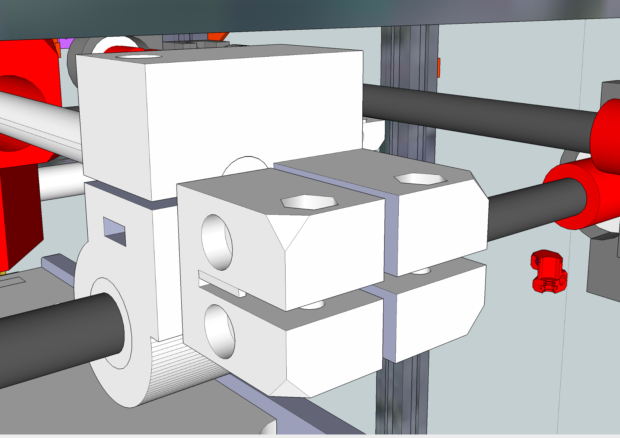

@Tim_Rastall This is what I was talking about having the ability to tension the belt in the slide itself.That block is free floating that gets pulled together with the 2 screw holes. BTW this is my little printer I have been playing with.
I am going to laser cut some parts I need tonight. I am not too far from assembling!
@denix , @Tim_Rastall . This is the same design that the Eustathios uses. Both designs were done in sketchup. There is absolutely 0 play/slop with gt2 belts.
@Jason_Smith I posted this because I was unsure how to post a photo to @Tim_Rastall 's post. So I just posted a pic on a new “thread”. Basically I really like @Tim_Rastall 's new design for the XY sliders. I was saying it would be perfect we could fit in a tensioner.
