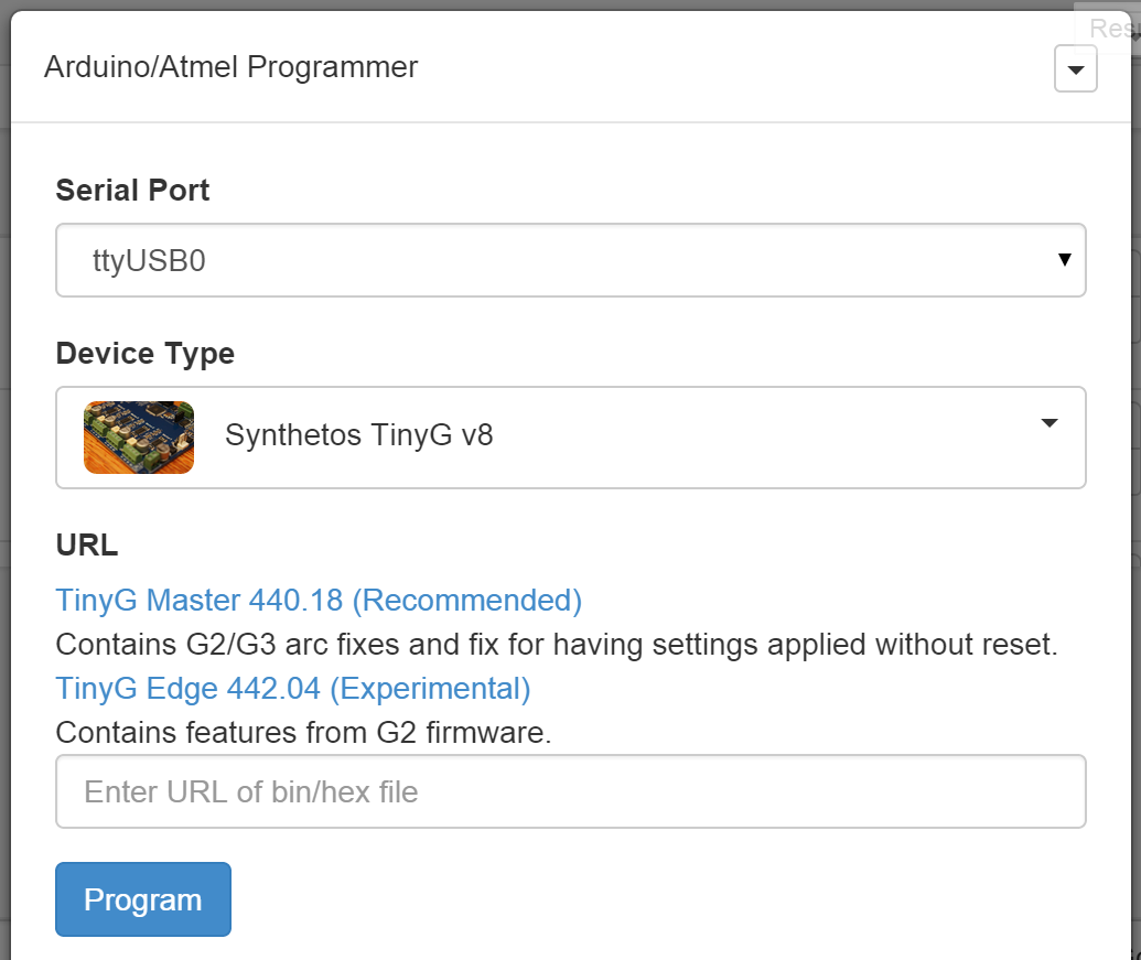

TinyG 440.18 is out. You can use the new firmware programmer in CP if you are running SPJS v1.83.
