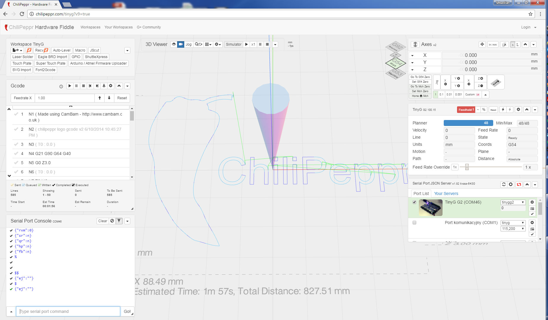

I have compiled latest g2 edge firmware (cloned from github): make BOARD=gShield SETTINGS_FILE=settings_3040.h and after connecting to SPJS board is non-responsive. Chilipeppr shows TinyG G2 100.15 but nothing else works - see screenshot attached. There is one serial port listed (COM46) while the same board flashed with 87.01 firmware build have shown two COM ports here and is fully operational
