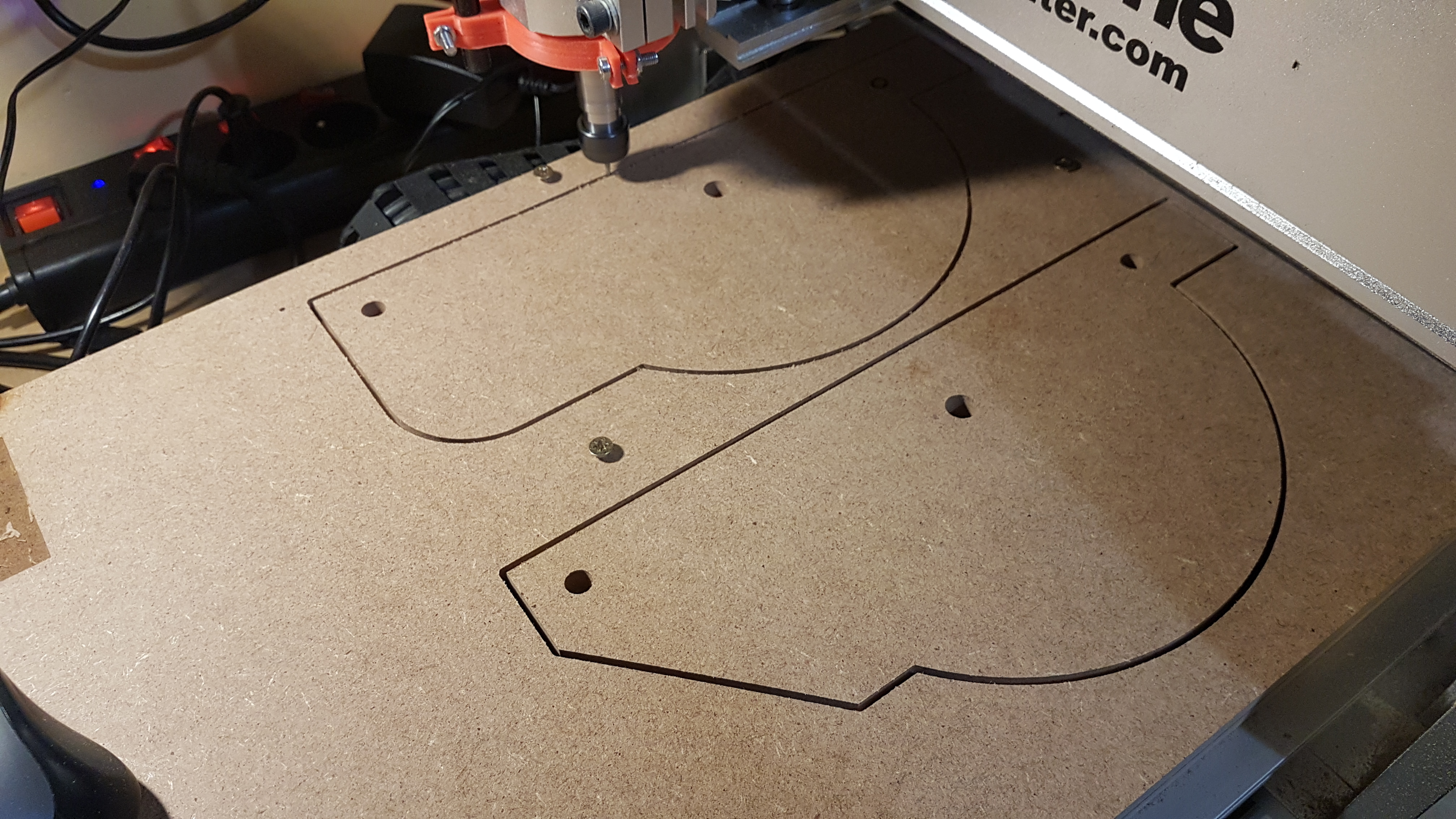

TinyG running Chilipeppr: material is 10mm MDF, 7 passes, 1.5mm each, total job time 34 minutes.

Tool size, type, speeds and feeds please?
This is 2mm 2 flute bit, feed rate 360mm/min, plunge 300mm/min, 12000rpm, machine is 3040 with 400W spindle motor.
Each pass is 1.5mm and I cut 0.5mm through the material to make sure part is properly cut out. There are 6x1.5mm deep tabs (effective depth is 1mm) to hold the part in place.
