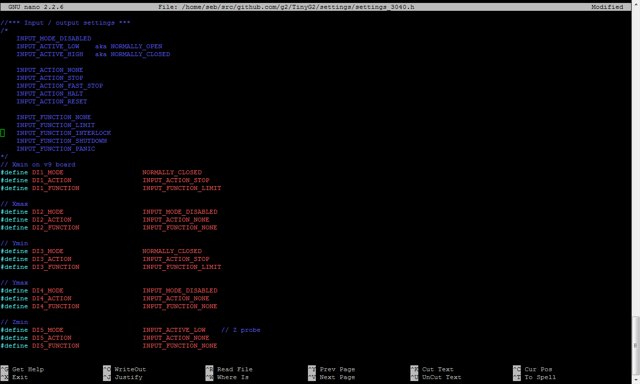

The probe pin is using Z_min_ (D18 pin on the Arduino Due) and according to the appropriate settings.h it is defined as:
// Z min
#define DI5_MODE INPUT_ACTIVE_LOW // Z probe
#define DI5_ACTION INPUT_ACTION_NONE
#define DI5_FUNCTION INPUT_FUNCTION_NONE
INPUT_ACTIVE_LOW is a NORMALLY_OPEN equivelent, which I would expect is correct for a probe. The probe pin (D19) should be held HIGH state (VCC = 3.3V for Arduino Due) until it touch the copper = gets connected to GND and changing state to LOW.
