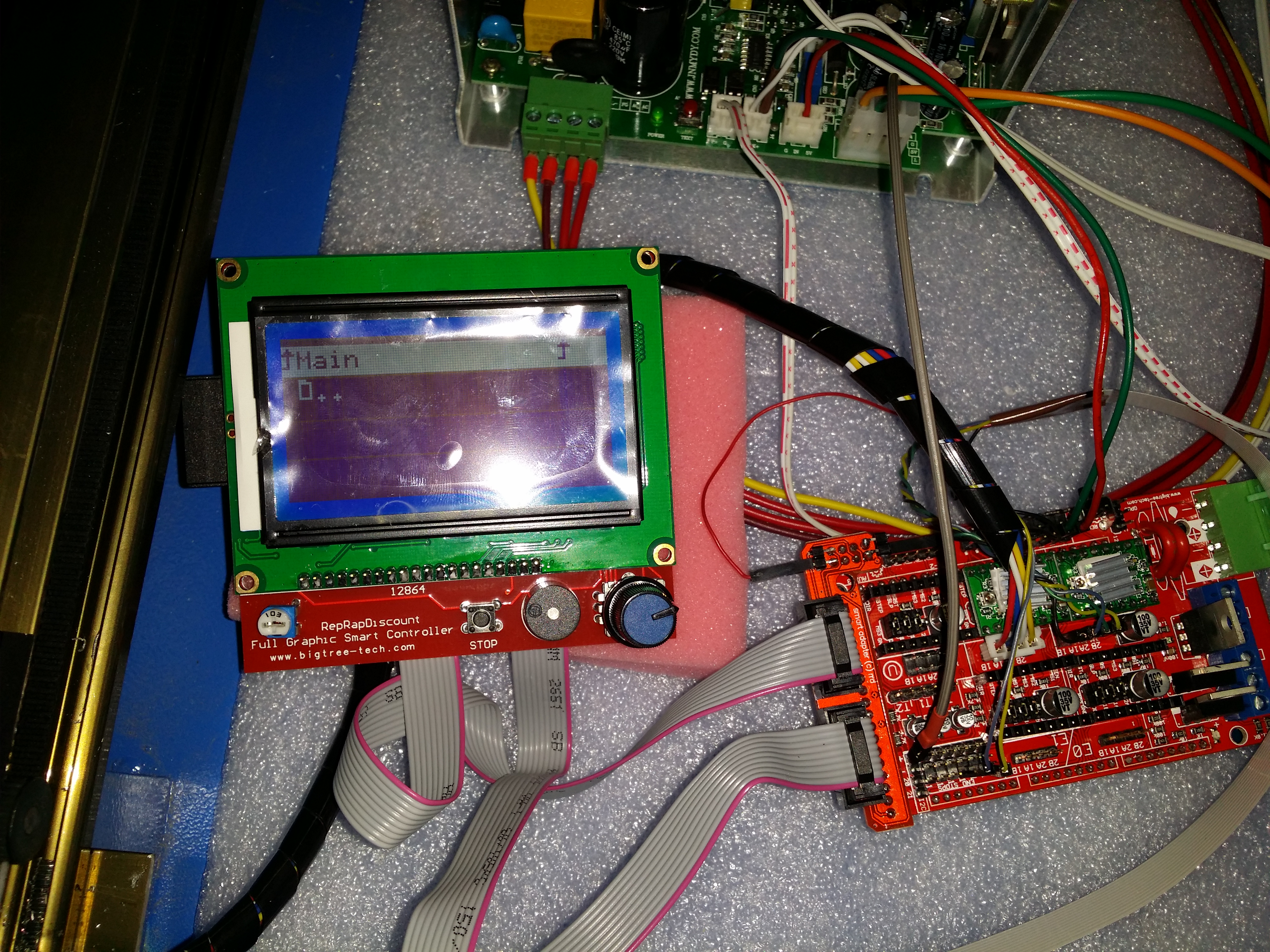

Tired getting inkscape plugin to work. Downloaded gcode file to test for the first time and now SD Card not working. Tried FAT and FAT32 formats. It’s Nokia 4gb class6. Any suggestions???
The filename of the gcode file should end in “.g”. Such as “file.g”
The SD card might be an issue, try another one if all else fails.
Try a 2GB Card if you have one laying around.
Hi Sean, My Marlin controller will only recognise 8.3 filenames on the SD card, hth David.
I don’t know about the marlin for laser cutters, but ik for 3D Printers, it will only show .g and .gco filename
I think that is exactly what I was trying to say Sean but it didn’t come out that way
I use Marlin on my 3D printer.
It’s all good lol
@Sean_Cherven it took me about 2 hours to find memory cards from my electronics junk. Found couple of Canon 32MBs
and a Sandisk 2GB. Both working perfectly. Also both .gcode a .g working exactly the same. Now time to get the Damn plugin working.
For some reason Turnkey plugin doesn’t show up under Extension>Export. Tried J Tech Photonic plugin. And it does shows up and create s gcode too.
