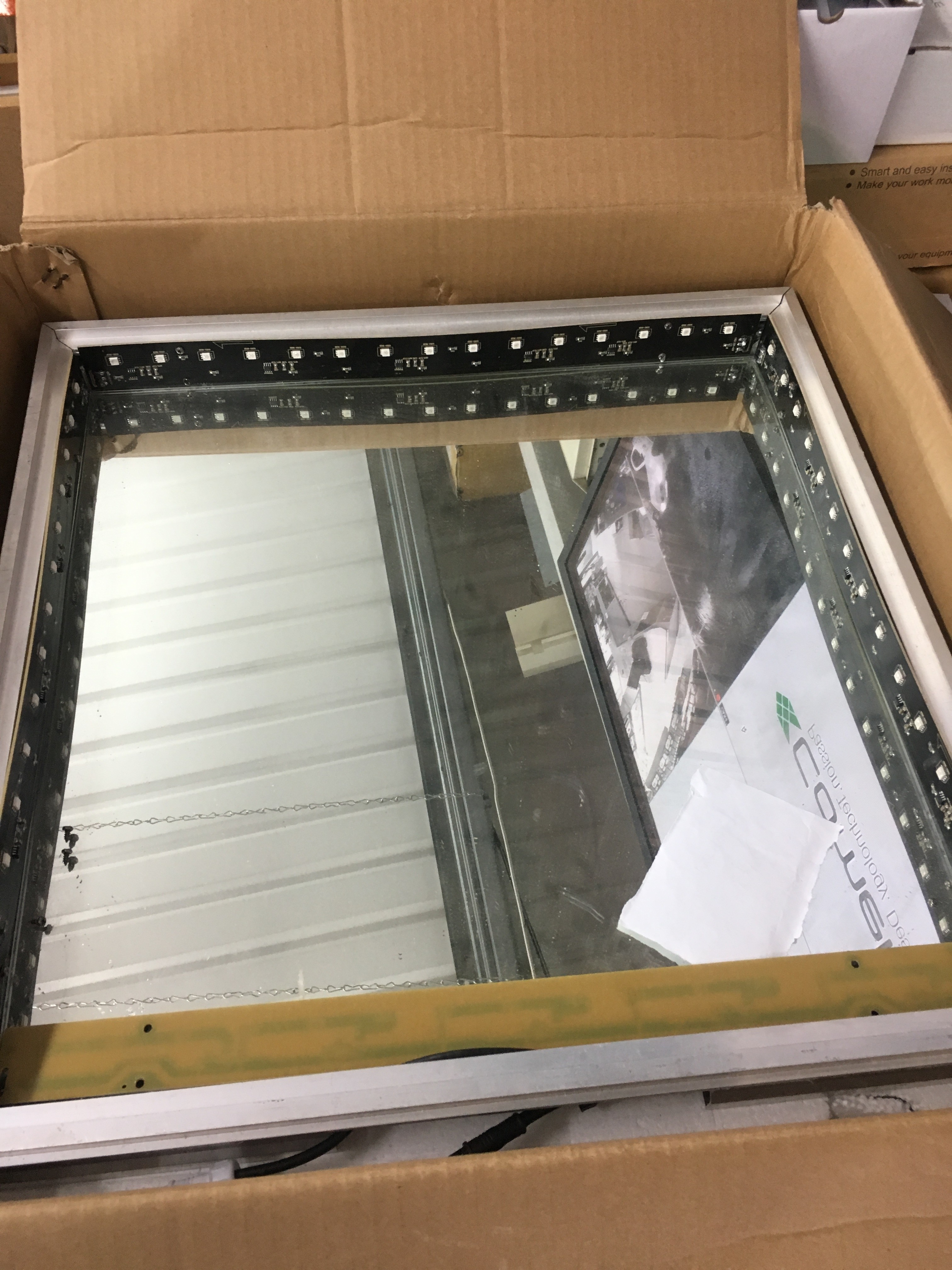

Is there an easier way to XY map a hollow matrix of square panels, with pixels on the inside edge (please see picture attached), so that;

A friend of mine bought an LED infinity dance floor (4x7 tiles) from China about a year ago. The build quality was poor and the type of LED limited the amount of control.
He’s asked me to rip out the base panels and refit with some better LEDs. There’s 28 tiles in total and I have now fitted 4 of them with WS2813 pixels @ 60LED/m
Each side is 26/27 pixels long giving a total of 107 pixels for each tile

Each panel has the first pixel starting from the top left corner, going downwards, all the way around until it reaches the top left corner again. I have then soldered a joining piece to some 1.0mm 3 core flex cable, onto an XLR connector, and straight into the next panel in the chain.
Because of this, when I output a rainbow pattern the colours of two adjacent tiles is out by a factor of 3/4 (I.e - side 3 of tile 1 is next to side 1 of tile 2 etc, if that makes sense)
I was looking at pixel mapping them (have done this before on the stairs project and a few others) but this time it’s a different ball game. This time the array I would be creating would be 108x189 pixels which gives a total XY map of 20,412pixels (including the null pixels) so it just isn’t that appealing to do it that way.
