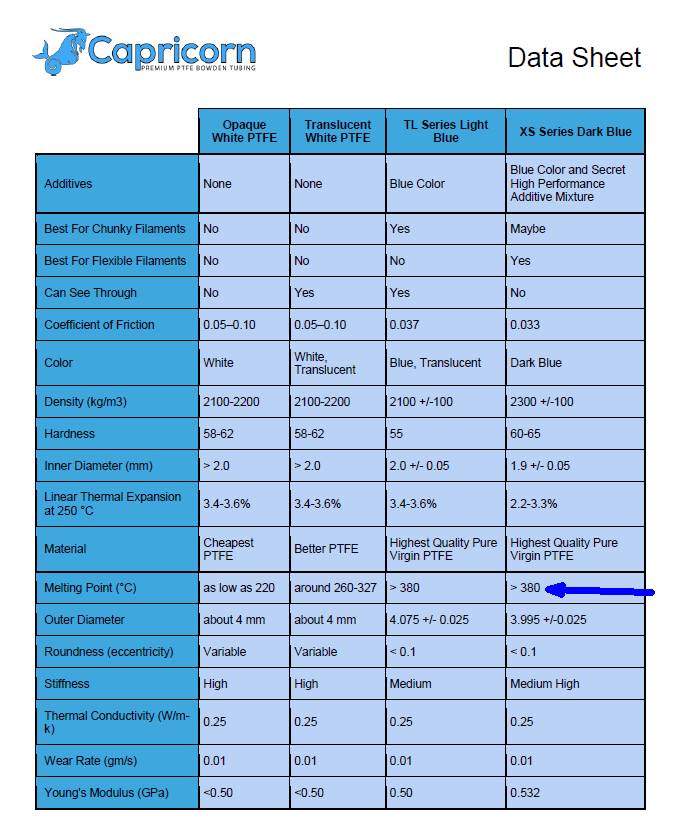

But I see your point, this has tragedy written all over it for the misleading temperature figures and “buried” and vague safety page.

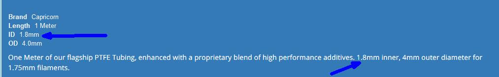

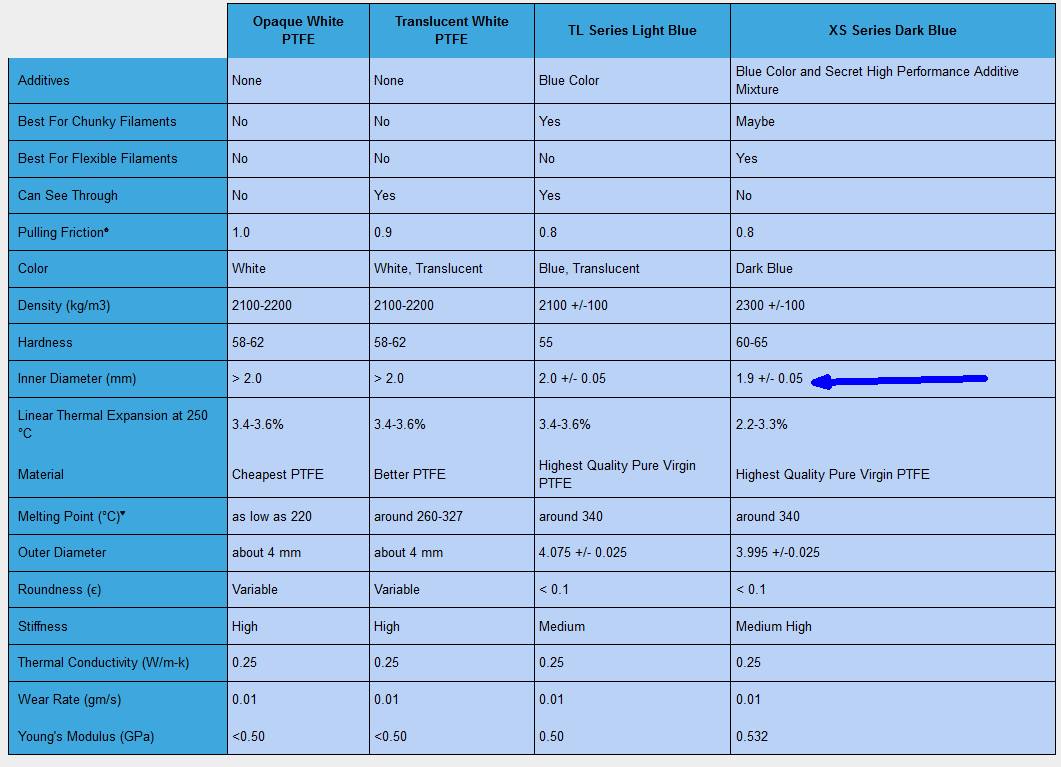

German facebook group is laughing about all the inconsistencies:

Well, I came across the captubes website today and found major changes were made to their product description.
They now do prominently state at the very top of their ‚technical specs‘ page that „Printing at high temperatures may create harmful off-gasing“. And when clicking a link further, one can find a nearly completely reworked spreadsheet about the temperature range of their „safe printing temperatures“, even with links to sources about how dangerous PTFE can be if heated to certain temperatures and mentioning the danger for your pets.
If I think about these changes, this is probably more than I would have wished for. Ok, they could have just listed a „recommended max service temp of like 260C“ in their spec-sheet, but I get it, they want to make their product special and I am fine with this.

PS: There are still inconsistencies of the 1,8/1,85/1,9mm measurements on your site - but that is up to Capricorn :wink:
