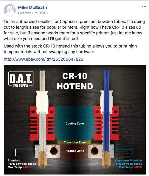

@Tim_Elmore The exact sites and postings I have in mind are lost in my extensive browser-history -.- I managed to find at least one posting in the lengthy feeds of social media that made me write this post:
Thanks for that. It looks like that is one reseller, not CapTubes. Would be great to take it up with them directly as I’m not sure they would have seen this post otherwise? Likely a reflection of that reseller’s limited technical understanding, not something malicious.

@Tim_Elmore That’s my post and was just linked to this. I took the info provided at face value. I removed the graphic referencing those temperatures.

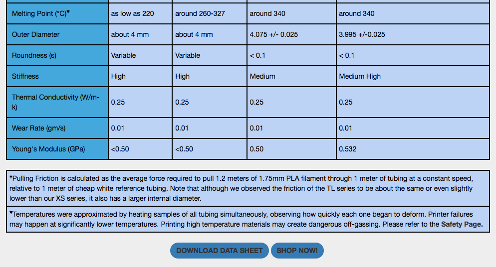

in technical datasheet on capricorn website it says a melting point of 340°C. Why they would write that there when it was not true? Please explain, I want understand this.
@Mike_McBeath_Jr thanks for trying to be a responsible reseller!
Well, standard PTFE melting point is 327°C. So not much difference there … and irrelevant data if you’re not interested in liquifying PTFE.
The data for regular opaque white PTFE seems misleading. https://www.captubes.com/specs.html
Then there’s this: https://www.captubes.com/safety.html

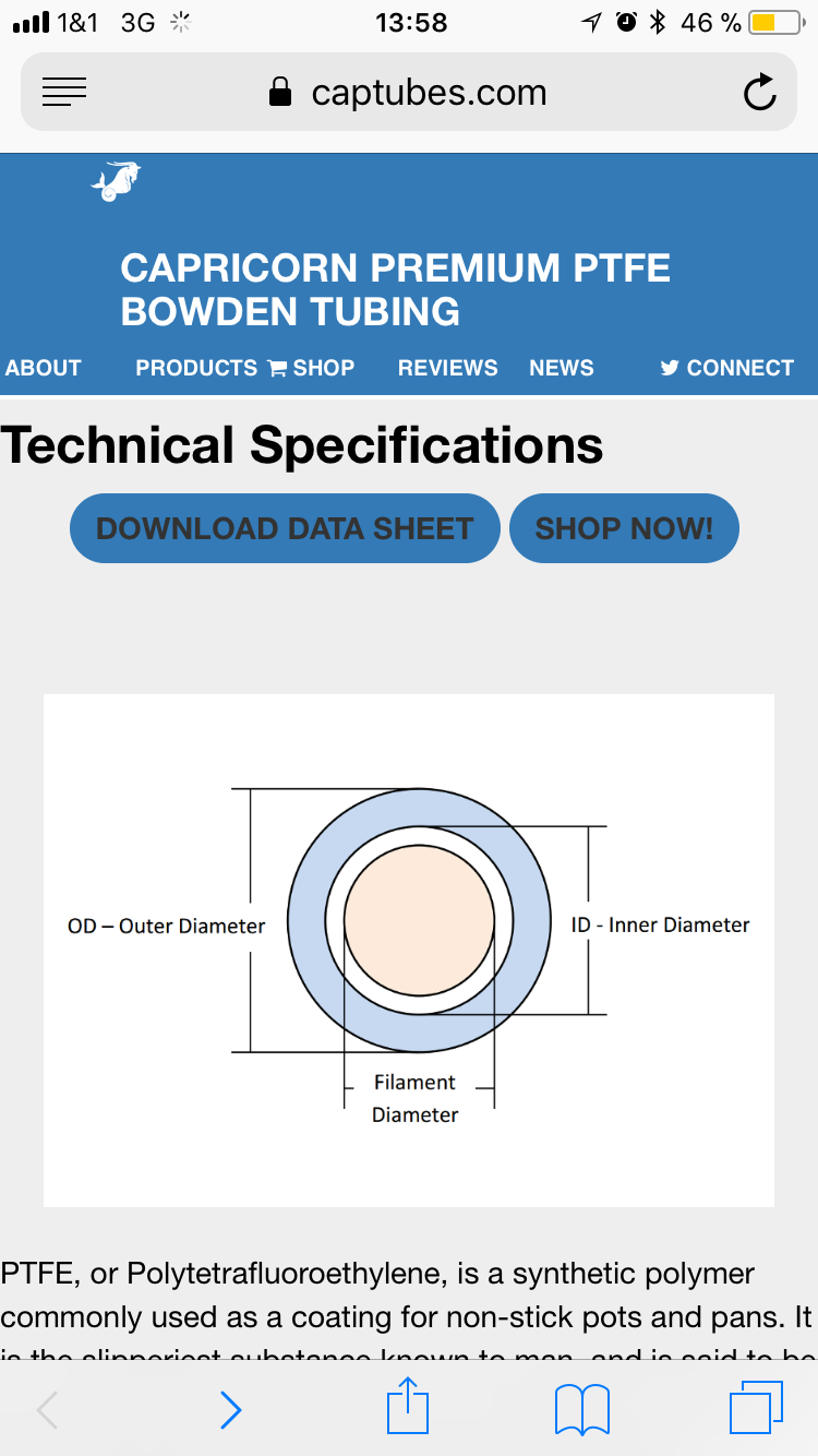

@Jeff_DeMaagd From where do they link to the safety-page? This is new…
Just above the “download data sheet” button on the tech specs page.
Oh, there’s a second instance of those buttons at the bottom end of the page.
