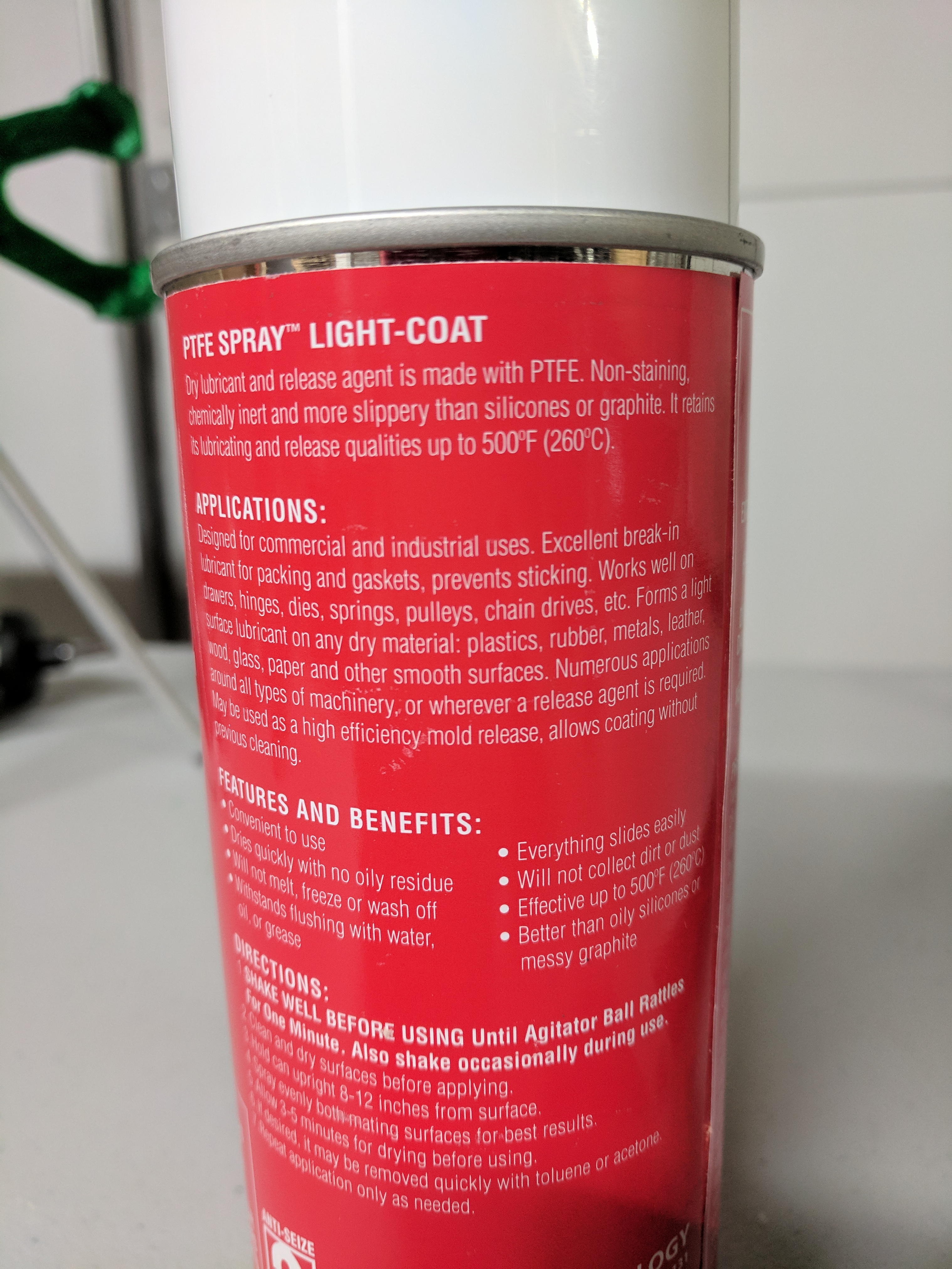

From the side of the can:
I usually preferr to use LM47 or sometimes even LM48 from LiquyMoly. The last one comes with the highest amount of Mos2 particles from the products that I’ve seen so far. But for bearings with this kind of load (On 3d printers) it probably doesn’t matter if you use ptfe or mos2 based grease. If it needs to be a thin spray I usually like to use Caramba Mos2.
