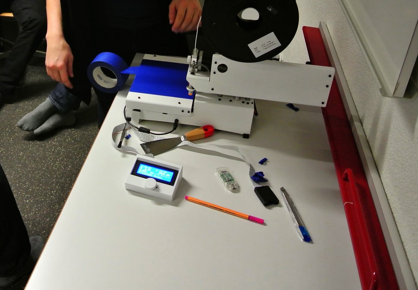

We run our Printrbot Simples allways by SD card. Because inserting the built in microSD card is too tricky, I added a SD card adapter. Due to the stress from inserting the adapter to the Printrboard, the adapter sticks no longer firmly in the slot (we use the printer in school).
